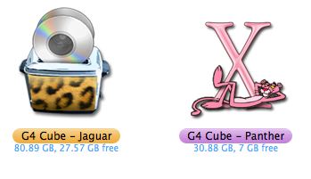

Wickedkitten Veteran Posted February 10, 2004 Veteran Share Posted February 10, 2004 How much space is free on the drive Neyo? I've got the same HD and over a year ago it started doing that because there was less than 10% of the total drive space remaining. Deleted some off off it and got it up to 40GB free and it stopped Link to comment Share on other sites More sharing options...

Steve Posted February 10, 2004 Author Share Posted February 10, 2004 How much space is free on the drive Neyo? I've got the same HD and over a year ago it started doing that because there was less than 10% of the total drive space remaining. Deleted some off off it and got it up to 40GB free and it stopped Oh i see Cat, well here's how it is... Its been 'normal' for the last 24hrs, seems fine. :unsure: Link to comment Share on other sites More sharing options...
