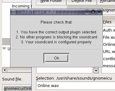

hornett Posted February 18, 2004 Share Posted February 18, 2004 Hi there, sorry for all these topics :p but I am so close to getting everything to work perfectly :) I get sound via OSS in xmms and other apps but Gnome will not play it's desktop sounds. I have ticked the box labels 'sound server startup' and 'sounds for events' in the control panel thingy, but no sounds are played. I've checked the usual volume etc but I don't think this is the problem as xmms works fine. Is there a config file I can alter to make sure gnome's sound server is using OSS rather than alsa or anything else? PS - I've googled and searched other forums with no luck. Link to comment Share on other sites More sharing options...

hornett Posted February 18, 2004 Author Share Posted February 18, 2004 Ah crap. I was hoping that wouldn't be the case. Maybe I should try and get alsa installed. Link to comment Share on other sites More sharing options...
hornett Posted February 18, 2004 Author Share Posted February 18, 2004 OK this is strange, I've just run alsamixer, and strangely I am able to control my sound volumes in there. This makes me think I am running alsa. However if I select the alsa output for xmms, I'm given a message about not being able to open the sound card. Anybody care to tell me how I can check what I'm running? Also will I need to uninstall OSS somehow before installing Alsa? Link to comment Share on other sites More sharing options...
metal_dragen Veteran Posted February 19, 2004 Veteran Share Posted February 19, 2004 Yes, you should probably uninstall OSS if you are using ALSA because ALSA includes its own OSS compatibility modules. To check if ALSA is already running, open up a terminal and type lsmod. This will list all the currently loaded kernel modules. Look for modules that begin with "snd-" (i.e. for my Soundblaster Live which has the emu10k1 chipset, one of my modules is called snd-emu10k1). There should be about 4-6 "snd-" modules loaded if you are using ALSA. You need to edit some configuration files to get ALSA to recognize your card though. This is all detailed in the documentation on the project's website here. Link to comment Share on other sites More sharing options...

hornett Posted February 19, 2004 Author Share Posted February 19, 2004 OK this is what lsmod gives me bash-2.05b# lsmod Module Size Used by Not tainted snd-pcm-oss 37252 1 snd-mixer-oss 11992 1 [snd-pcm-oss] keybdev 1952 0 (unused) mousedev 4244 1 hid 21156 0 (unused) usbmouse 2008 0 (unused) input 3200 0 [keybdev mousedev hid usbmouse] uhci 24496 0 (unused) usbcore 58400 1 [hid usbmouse uhci] snd-ice1724 17396 2 snd-pcm 55904 0 [snd-pcm-oss snd-ice1724] snd-timer 13252 0 [snd-pcm] snd-page-alloc 6004 0 [snd-pcm] snd-ac97-codec 37240 0 [snd-ice1724] snd-ice17xx-ak4xxx 1328 0 [snd-ice1724] snd-mpu401-uart 3136 0 [snd-ice1724] snd-rawmidi 12512 0 [snd-mpu401-uart] snd-seq-device 3920 0 [snd-rawmidi] snd-ak4xxx-adda 3532 0 [snd-ice1724 snd-ice17xx-ak4xxx] snd 27460 0 [snd-pcm-oss snd-mixer-oss snd-ice1724 snd-pcm snd-timer snd-ac97-codec snd-mpu401-uart snd-rawmidi snd-seq-device snd-ak4xxx-adda] 8139too 15240 1 mii 2304 0 [8139too] crc32 2880 0 [8139too] tuner 10272 1 (autoclean) tda9887 3100 1 (autoclean) tvaudio 13628 0 (autoclean) (unused) bttv 94432 0 (unused) i2c-algo-bit 6984 1 [bttv] i2c-core 12740 0 [tuner tda9887 tvaudio bttv i2c-algo-bit] soundcore 3332 4 [snd bttv] videodev 5664 2 [bttv] pcmcia_core 40032 0 ide-scsi 9424 0 agpgart 39576 0 (unused) bash-2.05b# Thing is, the alsa plugin for xmms won't work but the OSS one does! Link to comment Share on other sites More sharing options...
bladerunner81 Posted February 19, 2004 Share Posted February 19, 2004 looks like you are using 2.6.x-kernel branch, as there is an "snd-timer"-module inserted into the kernel (a newer feature of 2.6). there used to be quite a lot of issues with the alsa-code in 2.6, so you will have to be more specific. what soundcard? what dist? what kernel version (incl. patches)? does it print the "alsa starting...... [ok]" when booting up the machine? Link to comment Share on other sites More sharing options...
hornett Posted February 19, 2004 Author Share Posted February 19, 2004 (edited) Nope, it's 2.4. The distro is slackware 9.1. The kernel is the default acpi one (the non-acpi one works the same with regards to sound but does not shut down my machine properly). The sound card is a gainward hollywood 7.1 which uses the Envy 24 HT chipset. I'm about to reboot to see what messages about alsa are displayed as there are none in the system log. Thanks for the help :) Edit Just rebooted, the only things I saw about alsa were 'loading alsa mixer settings from ...' and 'loading oss compatibility modules for alsa'. Edited February 19, 2004 by hornett Link to comment Share on other sites More sharing options...

hornett Posted February 19, 2004 Author Share Posted February 19, 2004 I followed it to the letter but it didn't work! I went through and clicked m for all the modules I thought I'd need and then did the make bzImage make modules make modules_install part. It boots and has reiserfs support but it loads no modules! At least, lsmod displays an empty list. :( I think I must be doing something really wrong. Edit : USB and networking are working, but alsa isn't. I'm pretty sure I selected the right modules as well. :( Link to comment Share on other sites More sharing options...

hornett Posted February 20, 2004 Author Share Posted February 20, 2004 OK I recompiled with the sound drivers for alsa as part of the kernel, but although alsamixer is used to control the level of the sound, and it lists my device at startup, xmms cannot play as alsa but only as oss and also the gnome sound server will not play any sounds. Link to comment Share on other sites More sharing options...
kongit Posted February 20, 2004 Share Posted February 20, 2004 (edited) xmms can play with alsa, with oss emulation, it should be compiled in the kernel by default like the rest of alsa, no setup involved. I am listening to chameleon by herbie hancock right now through it. get a newer/different version if yours isn't working. did you unmute the controls? you can change their volume without unmuting them in alsamixer. press m to mute/unmute in alsamixer. also do you make any entrances for alsa before making the kernel in places like modules.conf or rc.modules? if you did you need to comment them out or delete them. when I updated kernels I had to do nothing to get the sound to work. Edited February 20, 2004 by kongit Link to comment Share on other sites More sharing options...
hornett Posted February 20, 2004 Author Share Posted February 20, 2004 (edited) I know xmms should be able to play alsa but mine won't. I've just noticed though, as root the plugin does not give me an error, but I still hear no sound. If I try this as a normal user I get an error. I've tried using chmod 666 /dev/dsp* to give me permission but there is no change. As root, with xmms playing I cannot get sound even if i adjust alsamixer. Also I store the mixer settings with alsactl store. Thank you for the help, and no I never adjusted any module files. :) Sorry to be annoying! Edited February 20, 2004 by hornett Link to comment Share on other sites More sharing options...
