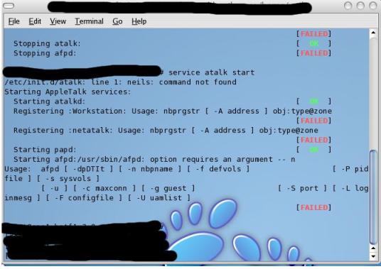

mcnelson Posted April 22, 2004 Author Share Posted April 22, 2004 Here's something else that may well be pertinent: remember....I have no idea what is going on here, go easy on me. Link to comment Share on other sites More sharing options...

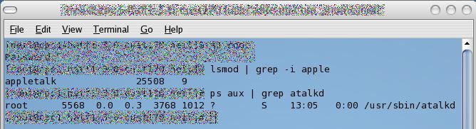

kemical Posted April 22, 2004 Share Posted April 22, 2004 is the service running? are the modules installed? lsmod | grep -i apple ps aux | grep atalkd Link to comment Share on other sites More sharing options...

mcnelson Posted April 22, 2004 Author Share Posted April 22, 2004 here we go: Link to comment Share on other sites More sharing options...
kemical Posted April 22, 2004 Share Posted April 22, 2004 ok we'll go through this step by step, your service is running(atalkd) and your module is installed(apple) now i want you to type hostname on the pc where the apple service is running, type /pathtoatalk/atalk_name it will then set your default hostname which is whatever you set your machine to, so if its mcnelson.com it will be set to mcnelson now run afpd_run it will determine if the AFPD should run, which most cases its yes. next run, atalk_bground, which will determine if the daemon will run in the background, default again is yes. once this is done, please post your atalkd.conf file, which is probably located in /etc/ directory so we can make sure that is set right Link to comment Share on other sites More sharing options...
