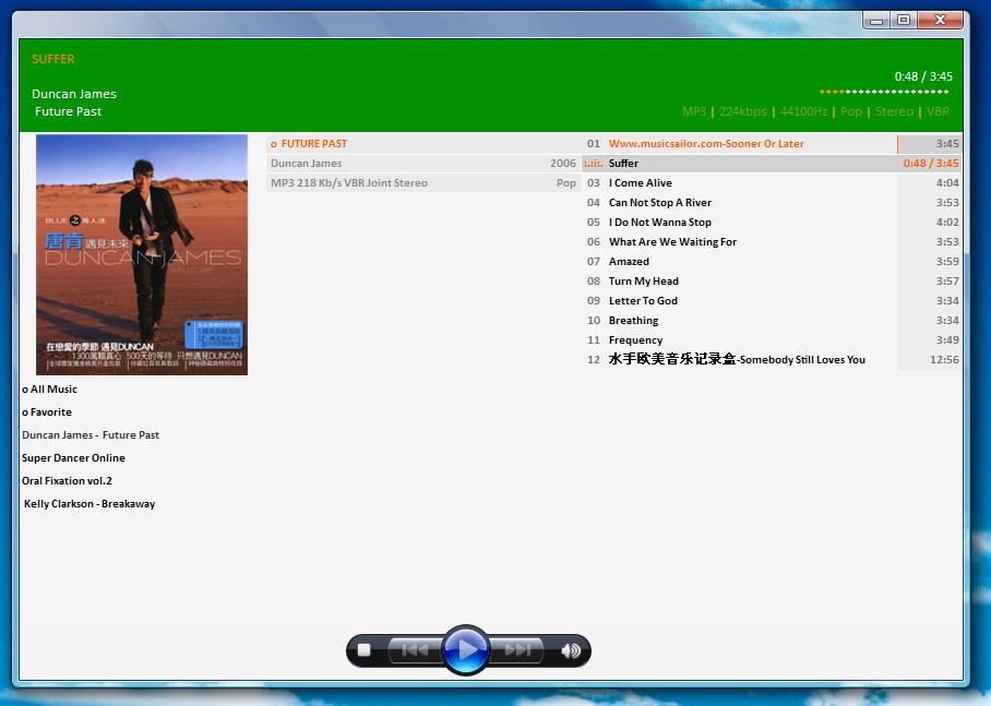

My Foobar 2000 0.9.2
Kinda vistalish.
/:)I don't know much about the configuration.
