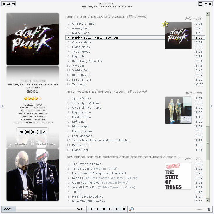

releasing my
[sFiNKS]DeathDossier:fb2k
DOWNLOAD
Installation:
1. Place "images" and "PanelsUI" folders to your 'foobar2000' directory.
2. Place font-file "Betina Bold.ttf" to 'C:\Windows\Fonts' directory.
3. Controll installed 'foobar2000' plugins, this config uses:
- foo_ui_columns.dll
- foo_ui_panels.dll
- foo_uie_albumlist.dll
- foo_uie_lyrics.dll [modified]
- foo_uie_powerpanels.dll
- foo_uie_quicksearch.dll
- foo_uie_vis_channel_spectrum.dll
4. Run 'foobar2000', go to "Preferences/Display/PanelsUI" and
change your 'Layout' to "[sFiNKS]DeathDosser-fb2k.pui"
5. Enjoy it... :)
you can download plugins I've used HERE
good luck

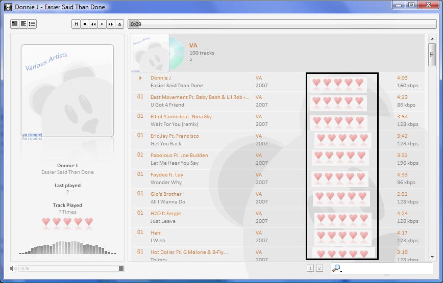

Well, everything functions but the images. Screen...
I checked out the code and everything looks cool as far as the directory and file names of the images. So, I fresh installed Foobar and the components included in the zip provided by you and got the same exact result. I'm wondering if possibly it could be an option specific, of component specific thing going on. I'll keep looking into the issue to see what I can come up with. Any help would be cool.

where have you placed the "images" folder? it must be in the './foobar2000' directory and not in './foobar200/PanelsUI'
if it is not the directory or the plugin version, I'm affraid I don't know where is the problem, I tryed to install it on a fresh installed Foobar and it worked finely.... I didn't use any specific option
ok, I think I've found the problem...
I think that, during the installation you have marked "Enable pre-user settings", this puts the config files in windows user folder
to resolve the problem there are 3 ways:
or
re-install foobar2000 without 'pre-user settings'
or
rename or delete "user_profiles_enabled" file in foobar2000 directory [remember, it will create a new "foobar2000.cfg" file, and your actual configs will remane in the old file in 'C:\Documents and Settings\USER NAME\Data applications\foobar2000\' directory]
or
put my image folder in 'C:\Documents and Settings\USER NAME\Data applications\foobar2000\' ... the path may change with diffrent language versions of windows
olso with 'Pre-user settings' ON, you may need to change setting of "Album List Panel" and "Playlist switcher": change background color to 230-230-230 and 'Edge style' - None
I hope it will resolve your problems
