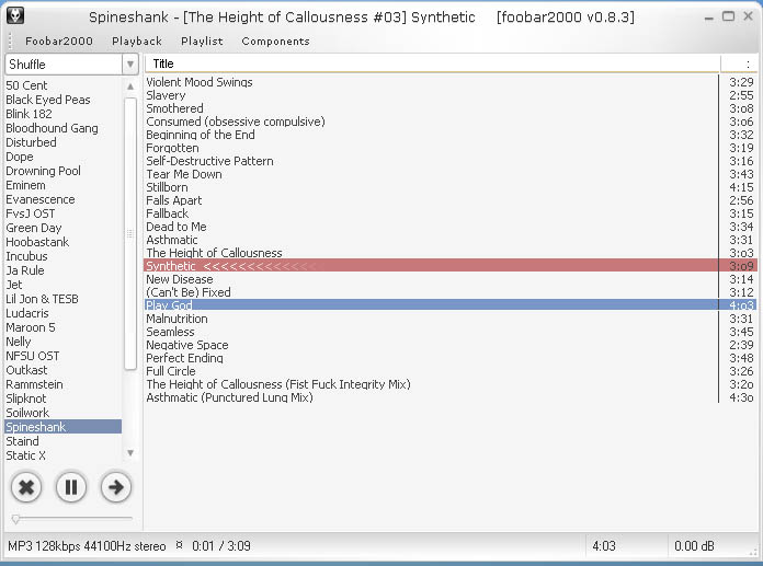

Thanks to this forum topic I have been able to modify my Foobar with alternate colors, get my database working, album list and a bunch of other mods to make foobar exactly what I need. One of the last things that I cannot get is in the pic below.
I would like to have on the first line the ARTIST. On the second line the ALBUM - GENRE. I have gone through other configurations but have been up able to find out how to do this. If anyone can assist that would be awsome. I look forward to showing my config soon.
