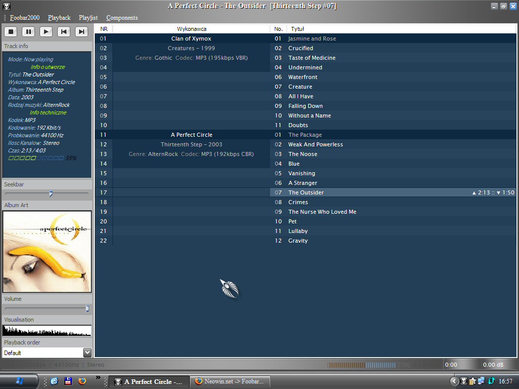

Hello :) This is my first post and my config.
My question is kind of silly and simple :unsure:
I can't figure out how to change the colour of % counter on the right of the progress bar ( track info panel ) . Thank You for future help.
I've learned a lot from this topic ;) Thanks everyone!
Well it's the normal sidebar with some plugins:
foo_uie_albumart_v0_034 ( must have msvcp71.dll installed in the foobar dir )
and foo_uie_trackinfo
Everything I done is based on this very topic and links to the hydrogenaudio.org forum ( links were posted a few pages ago here also )
Usefull links:
http://www.hydrogenaudio.org/forums/index....opic=29383&st=0
for the album art
and
http://www.hydrogenaudio.org/forums/index....showtopic=29363
for the track info panel
But this topic will give you every necessary info of how to do it .
Found the DLL's at a convinient site for the exact problem - http://www.dll-files.com/
Another question tho, How do i get the track info panel to work in "Now Playing" mode ?
its always on follow cursor, even if i turn that option off in foobar.
EDIT: Nevermind, found that quickly aswell xD

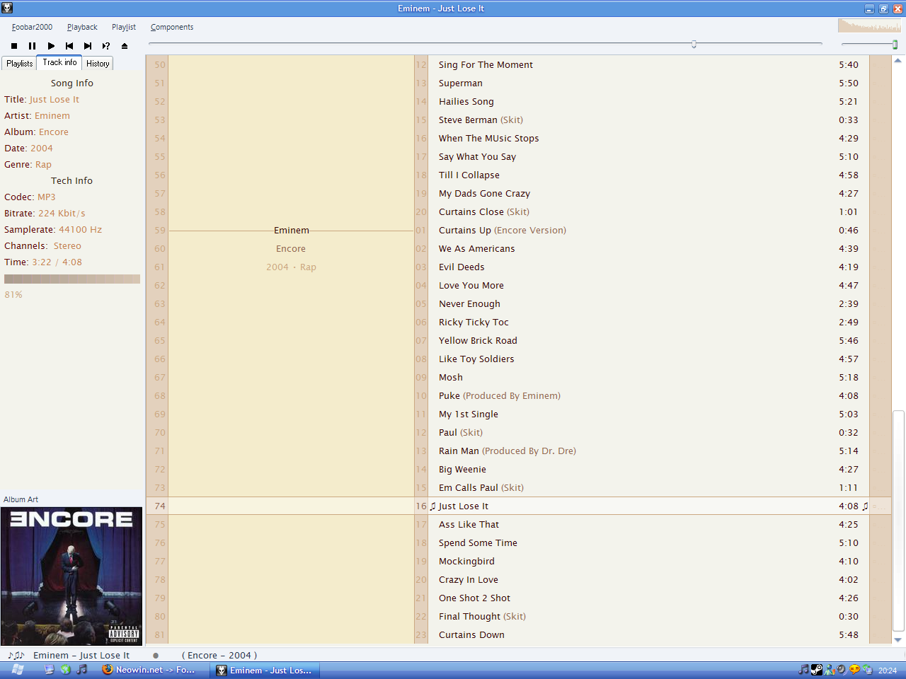

It looks great Neksus. I've got a question thou. I just can't find the option... how to change the inside colour of the side panel..I mean that when it's displaying such words as seekbar, trackinfo etc. That colour which in your config is yellow f.e. under the buttons.
I want to change the colour to match my windows blinds skin. And my setup is on the previous page (59) ...that should give you an idea of what I meant if I couldn't explain correctly.
Thank you for future answer.
P.S. Fab music you have there. This new Illdisposed is damn good.:)
Edited by Dorian
584964407[/snapback]
I like to know that as well.
Also, how have you guys changed the seekbar and volume indicator graphics?
@Dorian
Thanks! It as already changed! See my new setup attachment!
About your question:
You can't they get their color from your skin!
And yes the new illdisposed kicks ass, I am going to see them live this saturday!

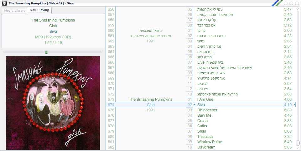

It's been a while since I posted a foobar shot. Here we go... just to show off the bicubic interpolation in the album art :laugh: . I'll release the new version of the component once I have some time to figure out some bugs with the new wildcard matching in sources (oddities with special characters).
How do you go about changing the slider button graphic for the seekbar and volume? I can't find anywhere to change it. Is it a hack of the foobar executable?
584967099[/snapback]
The graphics for those depend on the skin you are using.
