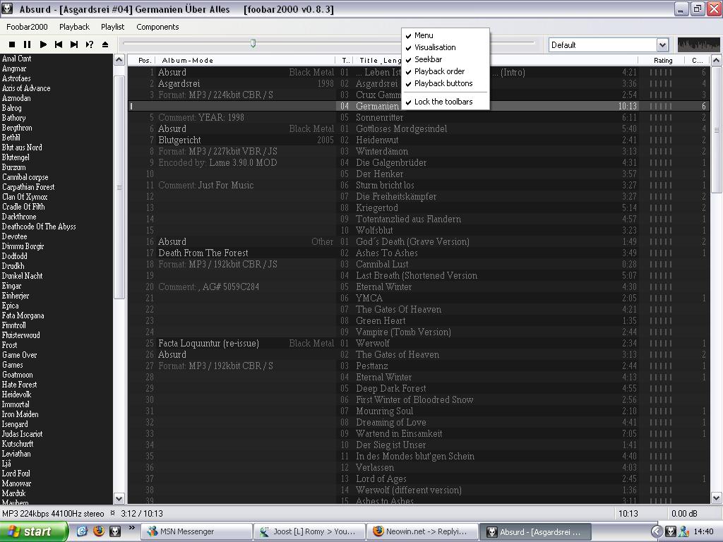

Im a newbie at foobar modding , i have 2 questions that i like to see someone help me out :D
1: - I see a lot of people have this visualization :
I already tried foo_simple_spectrum, but it seems thats not the plugin needed cause i cant have one like this, could anyone help please ?
2: - How can i change the colors in the 2 selected blue areas ? i would like to put a light green , but the colors in foobar appear in a strange format that i cant understand,so i cant put the colors i want.
heres what i want to change :
Help is very welcome \o/
Thanks a lot
Bye.

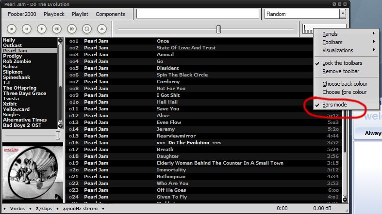

Hi,
I solved the problem with the colors, i managed to understand the script and now its ok :D
What i cant put working is this :
May anyone heklp on this one and tell me what to do to have a visualisation (spectrumvisualisation) like that , please ?

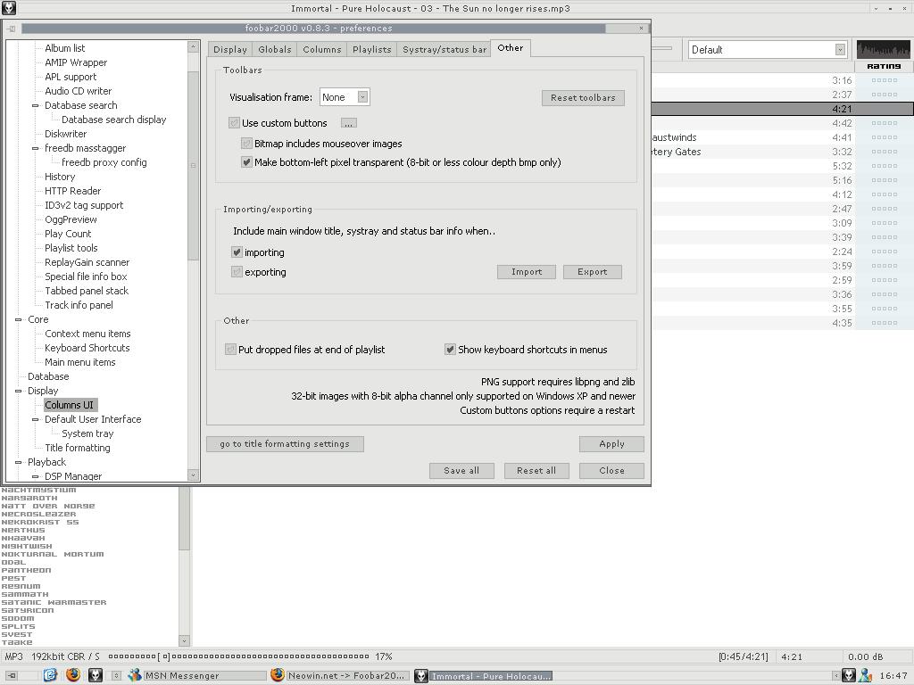

Hmm, The tabbed stack plugin is installed but i cant add it anywhere. Lots of panels just dont show, even that i have CUI 0.1.2 and have checked the "List All Toolbars" Button. No plugin shows as unable to load in foobar either, so im baffelled here. Help ? :)
