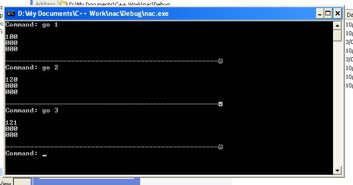

Im working on a simple Console based Tic Tac Toe game, just for learning experience, and after i compiled and ran it it did something weird. (View screenshot)
The smiley looking characters at the end of each dashed line, is not located in my program, and I cannot see why it would appear.

I am using Windows XP professional. I used Visual C++ v6.0 to compile it, and the source above, after recompiling, kept this weird error.
Does anyone know why this happens, or could they compile it if they use Visual c++, and tell if the same or similar error happens?

hmm, u are placing a 60 character string in a 50 character array
strcpy(bigline, "------------------------------------------------------------");
not sure if its that the problem, but its not good to overflow an array.
  • 0
Ohhh woops, I just realised after u posted that it was probably that i hadnt allowed enough room in the bigline[] array, still kinda weird that it showed a smiley though, anyone got a reason why it was a smiley, and not a mooshed up piece of junk?
  • 0
i suppost you where trying to access a piece of memory which you are not allowed to.
if you placed the bigline[] at the top, you would have seen the contents of the other before the other declarations.
