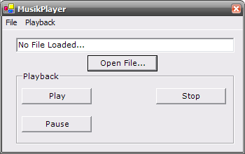

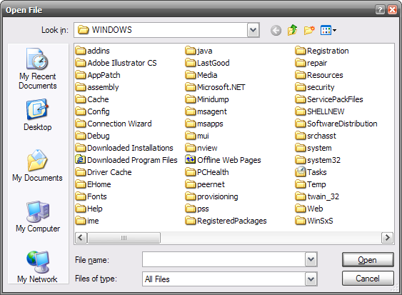

I'm just starting out with VB and I'm curious as to how I would open a file. I'm thinking of having a simple MP3 player as my first project (not some flashy thing with a playlist). Any help would be greatly appeciated.
In case you don't know what I'm talking about, I'll attach a screenshot of what I want.

Yes, its called OpenFileDialog and should be pretty easy to use.
Dim openFileDialog1 As OpenFileDialog
openFileDialog1 = New OpenFileDialog()
openFileDialog1.InitialDirectory = "c:\temp\"
openFileDialog1.Filter           = "All files (*.*)|*.*"
openFileDialog1.FilterIndex      = 2
openFileDialog1.RestoreDirectory = True
If (openFileDialog1.ShowDialog() = DialogResult.OK) Then
     fName = openFileDialog1.FileName
     'blah
End If
From: http://www.codeguru.com/vb/gen/vb_misc/ico...icle.php/c5597/

Yeah, probably. But like I said it's only a simple thing. It virtually only consists of a browse button. :blush: Well, aesthetically only consists of a browse button.

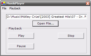

Well, I worked out how to exploit the WMP component to play MP3s. I even went as far as adding some playback buttons. The only thing I've got to do to make it complete now is work out how to update the text box to show the path of the file. Any ideas? :(

Hi Shannon,
Try adding the following to your 'open file button' subroutine . . .
Dim selection As String = OpenFileDialog1.FileName
TextBox1.Text = selection
Once you have selected a file, the file name is placed into the string called selection and then you can make your textbox equal to the string.

Ahh... works like a charm! Thanks! :D
