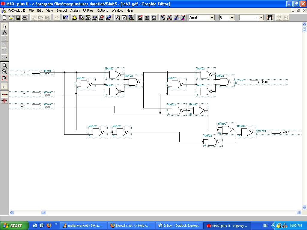

Here's a One Bit Full Adder. You stack four of this up, you have yourself a 4 bit Full Adder. For example, if you have
ABCD
+EFGH
This adder will add D and H, and produce a sum and Cout, which is the carry for the addition of C and G.
Edit: I made this out of NAND gates only because it's easy for CMOS implementation. It's a whole lot easier you use various other gates.
