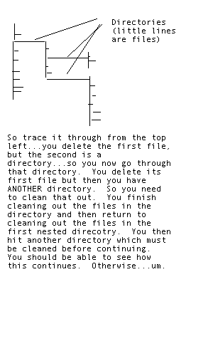

0 amoeba Posted September 26, 2004 Share Posted September 26, 2004 Well, the stack data type is a special data type (abstract data type). It basically has two main functions: push and pop. Push is supposed to toss something on top (visually speaking) of the stack and pop takes something off. It's like a stack of plates. You get to them from the top, and add from the top. The idea with recursion is to take advantage of this super-simple way of dealing with data. In my experience, recursion is used to get to the end of something, a list, whatever (directory tree example before was great). Once you get to the end of your looping (often a while loop), the while loop no longer executes and something is executed for each stack frame as you slowly work your way down the stack (of plates? :) ). In the directory case given earlier in this thread, you'd be deleting on condition (if is file). I dont know if what I said made any sense. Recursion seems like it can be less code but harder to figure out (at least for me) and not always as effecient. I stay away from recursion as it takes smart people to write good recursion :) Oh, and said above was that sometimes recursion requires a helper function. It might sometimes but having a helper function means the recursion isn't all that slick anyways. Recursion should stay pretty simple and doing magic stuff with helper functions just takes away from the elegance that is recursion. Blah! :p Link to comment Share on other sites More sharing options...
