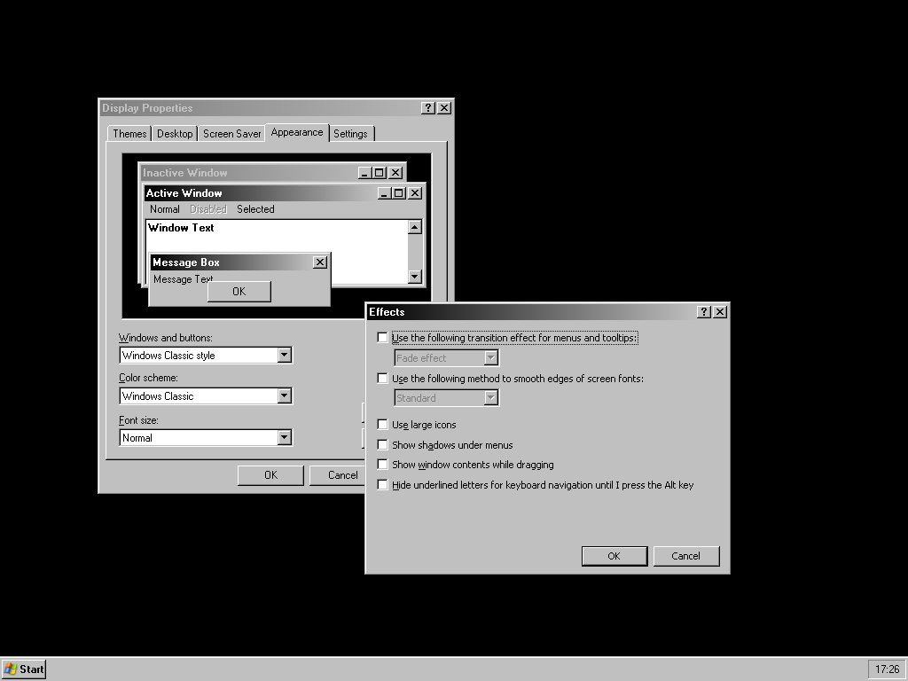

The thing is, everytime I log onto a computer at college it wipes our personal settings.. There's an attached image of what the desktop looks like.. Now this is probably me being very fussy but I just can't live with these settings.. I find myself wasting the 1st 5 or 10 minutes of the lesson setting it back to decent settings.. No font smoothing, grey as hell.. yuck! It just puts me off working..

I don't have time to actually write the program at the moment, but if others can help mark, I believe you can use the following APIs:
SystemParametersInfo(SPI_SETFONTSMOOTHING, TRUE, 0, SPIF_UPDATEINIFILE | SPIF_SENDCHANGE); SystemParametersInfo(SPI_SETFONTSMOOTHINGTYPE, FE_FONTSMOOTHINGCLEARTYPE, 0, SPIF_UPDATEINIFILE | SPIF_SENDCHANGE);
See: http://msdn.microsoft.com/library/default....ontext_0xgn.asp
This is only cleartype by the way. You can do similar things with display using SystemParametersInfo for whatever you need. Just look on MSDN for more info.
You may be able to use this also:
SystemParametersInfo(SPI_SETDESKPATTERN,0,NULL,WM_SETTINGCHANGE );
Hope this helps
