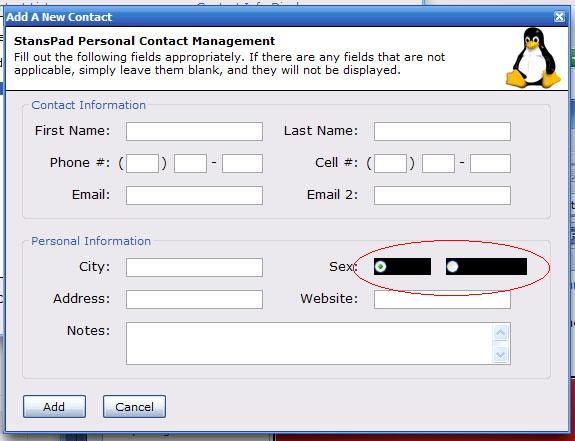

0 Brad87 Posted October 17, 2004 Author Share Posted October 17, 2004 ok i have that working properly,,, the only problem now is these option buttons,,, any suggestions? Link to comment Share on other sites More sharing options...

0 goatsniffer Posted October 20, 2004 Share Posted October 20, 2004 Sorry, I left out alot. For one thing, to fix the blackened controls, put them in a picturebox. Change the appearence of the picturebox so it is camo-ed into the background. Next, for the XP style you need a declaration in a module, or at the top of the form that starts when the program starts. Declaration for module: Public Declare Sub InitCommonControls Lib "comctl32" () Declaration for form: Private Declare Sub InitCommonControls Lib "comctl32" () USE ONE ONLY Then put this in the form that starts when the program starts. Private Sub Form_Initialize() Call InitCommonControls End Sub Link to comment Share on other sites More sharing options...
