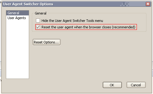

+M2Ys4U Subscriber¹ Posted February 27, 2005 Subscriber¹ Share Posted February 27, 2005 Make sure that this option is selected: And the problem shouldn't happen again... Link to comment Share on other sites More sharing options...
Tomi Posted February 27, 2005 Author Share Posted February 27, 2005 Yeah, I figured it out. It's odd, because I do have that secound option enabled. =\ Link to comment Share on other sites More sharing options...

arrrgh Posted February 28, 2005 Share Posted February 28, 2005 I tested user agent switcher earlier.. 6 months ago or so. At least back then it didn't always recognize that I closed Firefox, hence making the reset user agent when browser closes option useless. Back then at least using mouse gesture to close Firefox didn't reset the user agent. Link to comment Share on other sites More sharing options...
Tomi Posted February 28, 2005 Author Share Posted February 28, 2005 Then again, Firefox did crash, so maybe that's why. Ahh...it clicks together now. Link to comment Share on other sites More sharing options...
