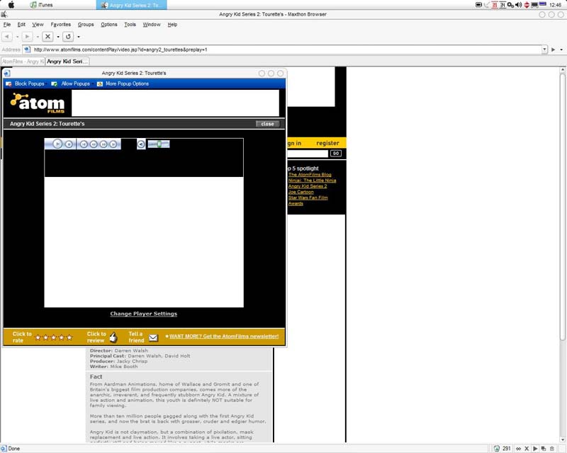

mattmatik Posted July 2, 2005 Share Posted July 2, 2005 I've ran into a problem recently where I no longer can watch videos in my browser. I use Maxthon but I also tried in regular IE and it does the same thing. I've provided a screenshot of what happens. How can I fix this? I tried disabling all filters and ad-blocks but that doesn't solve it either. Thanks :) Link to comment Share on other sites More sharing options...
Preppy Veteran Posted July 3, 2005 Veteran Share Posted July 3, 2005 ^-- This means that WMP isn't able to load wmploc.dll properly. What are the file versions of wmploc.dll and wmplayer.exe and wmp.dll on your system? Link to comment Share on other sites More sharing options...

Preppy Veteran Posted July 4, 2005 Veteran Share Posted July 4, 2005 Okay, according to tlist, that AtomFilms page pulls in wmpdxm.dll, wmp.dll, wmploc.dll, wmvcore.dll, wmasf.dll, wmnetmgr.dll, wmadmod.dll, and wmvdmod.dll (if we ignore everything but what is included in the WMP10 package). wmpdxm.dll handles embedding wmp.dll with the ui of wmploc.dll. What is the version of wmpdxm.dll? If you run: regsvr32 wmp.dll regsvr32 wmpdxm.dll , does that correct this error? I'm still curious about the source of this, and definitely know a work-around, but I'm trying to find you a solution here. =) Link to comment Share on other sites More sharing options...
