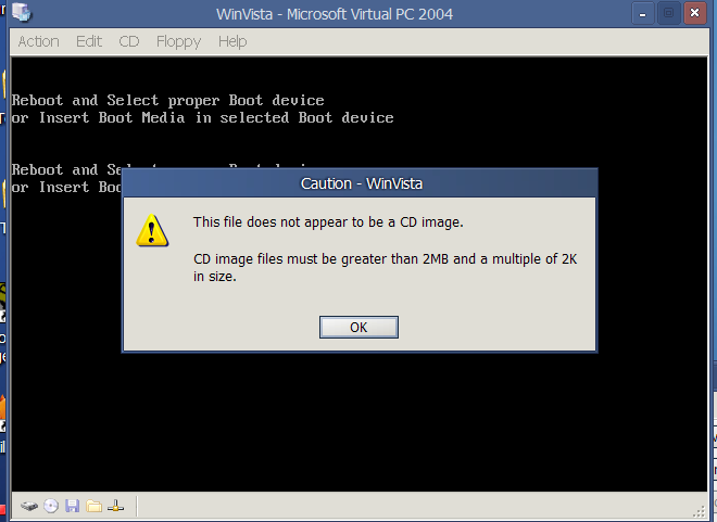

krishna Posted July 29, 2005 Share Posted July 29, 2005 I'm getting below error Link to comment Share on other sites More sharing options...
Dane Posted July 29, 2005 Share Posted July 29, 2005 I'm getting below error 586291700[/snapback] Are you using the .iso directly? If not try doing that it should work without any problems. Link to comment Share on other sites More sharing options...

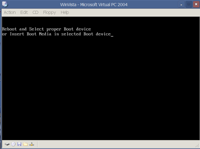

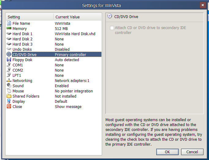

krishna Posted July 29, 2005 Share Posted July 29, 2005 (edited) Are you using the .iso directly? If not try doing that it should work without any problems. 586291863[/snapback] Nope. Burned on to a DVD. I will try and let you all know. Update: Here is the help file info on DVD Capture "Virtual PC supports .ISO images to a maximum file size of 2.2 gigabytes. " Moreover I get this error when I do capture ISO image: Update 2: Got it working. You need to make CD/DVD as your primary controller and RESTART Virtual PC 2004 (IMPORTANT). Thanks. Edited July 29, 2005 by krishna Link to comment Share on other sites More sharing options...
