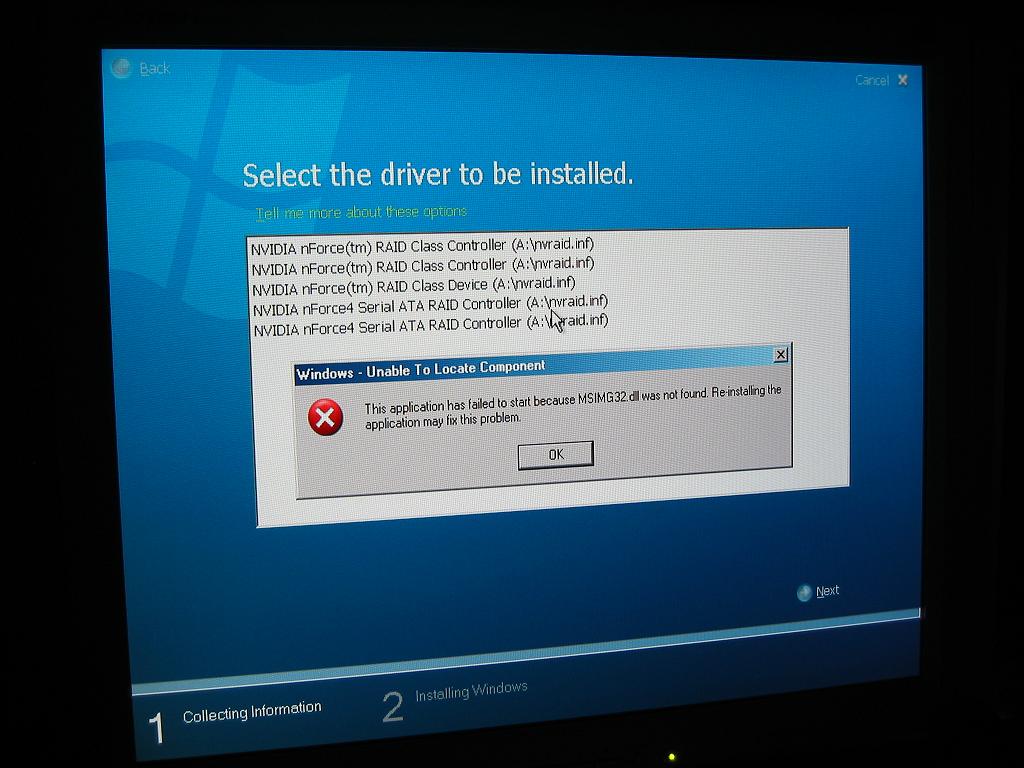

DOCa Cola Posted July 29, 2005 Share Posted July 29, 2005 i already tried it that way with nvidia raid. but setup keeps telling me then after i try to load the driver (it gave me the list and i click next) that msimg32.dll was missing and the driver could not be installed. any ideas? i have to use the driver as i have a raid 0 running on my a8nsli mobo Link to comment Share on other sites More sharing options...
DOCa Cola Posted July 29, 2005 Share Posted July 29, 2005 here is a screenshot Link to comment Share on other sites More sharing options...
rovman Posted July 29, 2005 Author Share Posted July 29, 2005 If you could post me a link to somewhere online where i can download your drivers i will have a look and see if theres anything i can do. Link to comment Share on other sites More sharing options...
