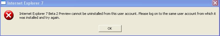

stiven Posted February 3, 2006 Share Posted February 3, 2006 HI... I even have a worse problem my firewall asked me about adding something to run everytime when I start my computer while installing IE 7 beta well the installed failed but can't uninstall because I get message that I installed it under different user account! What do I do now? Link to comment Share on other sites More sharing options...
