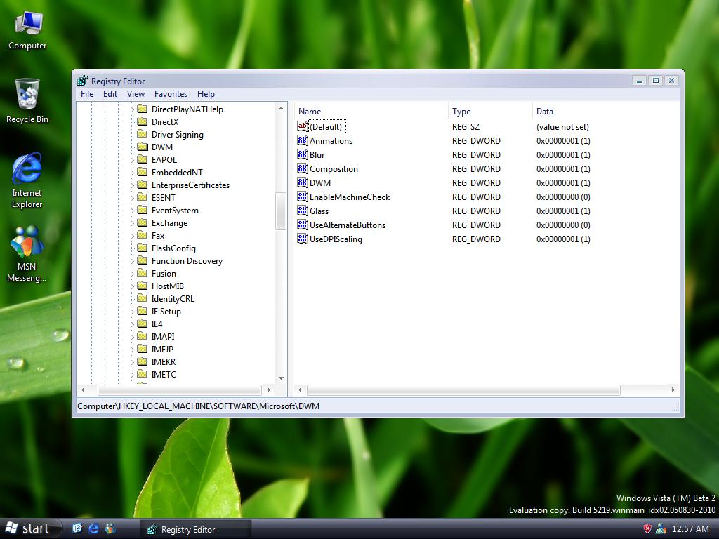

HalfLing Posted September 21, 2005 Share Posted September 21, 2005 These are my settings (I did a restart after creating the registry info) Still no glass? Any help? Thanks, Jake- Link to comment Share on other sites More sharing options...

HalfLing Posted September 21, 2005 Share Posted September 21, 2005 Are my settings correct? See previous post w/ screenie... Thanks, Jake- Link to comment Share on other sites More sharing options...

spclffred Posted September 21, 2005 Author Share Posted September 21, 2005 Are my settings correct?See previous post w/ screenie... Thanks, Jake- 586556316[/snapback] Yes ur settings are correct but i dont know why it isnt working for u. Did u reboot after u did the reg tweaks. Link to comment Share on other sites More sharing options...

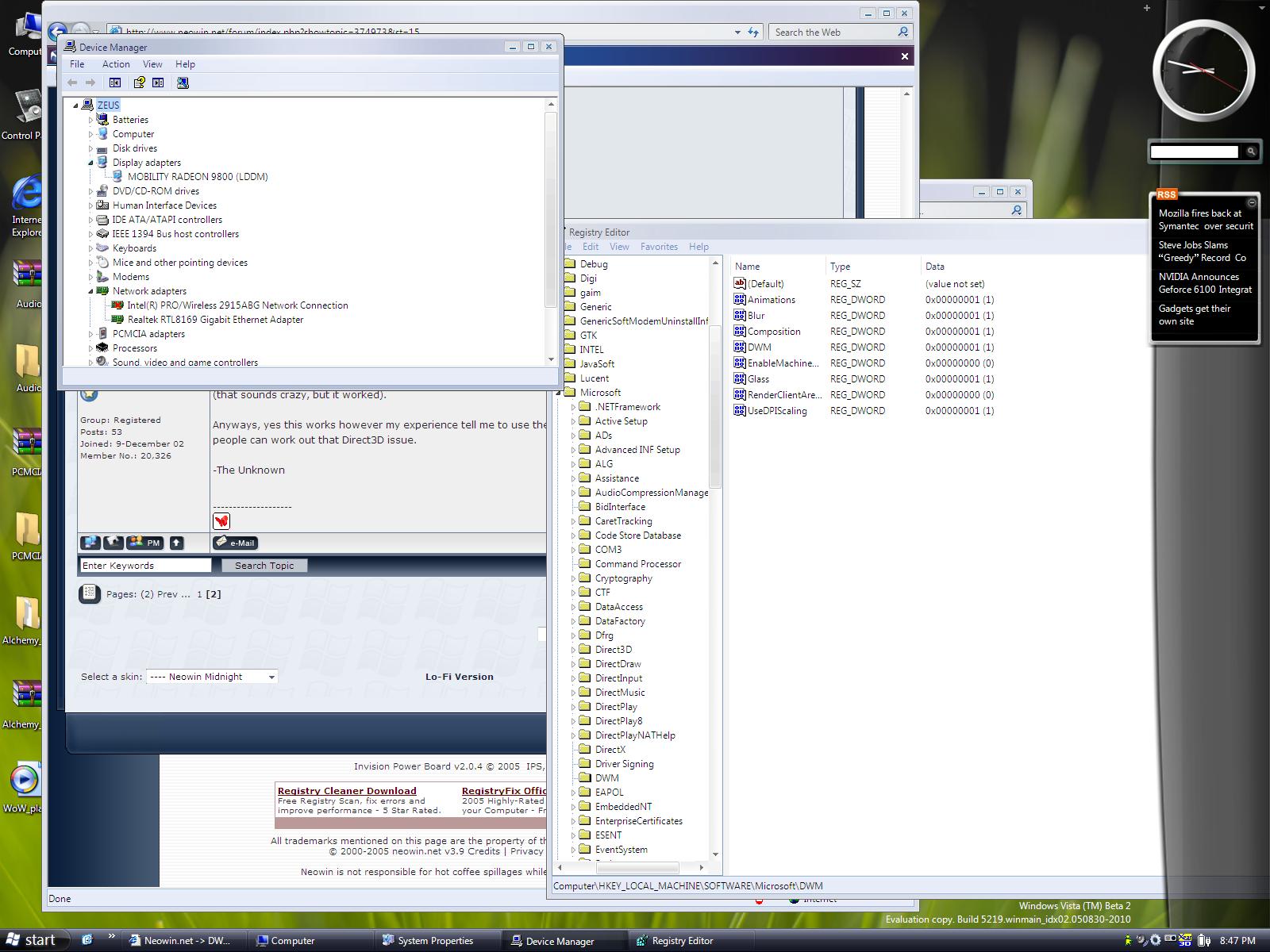

Sound.Phucker Posted September 30, 2005 Share Posted September 30, 2005 So I tried what you said. I uninstalled the Nvidia drivers and re-installed the Supplemental Drivers. I then entered the keys and I still dont see anything. Here's a pic. What's wrong? Link to comment Share on other sites More sharing options...
Commodore Max Posted September 30, 2005 Share Posted September 30, 2005 Check your drivers, Sound.Phucker (cool name :laugh:), I have 77.77 installed (Nvidia) and it works perfectly ! Link to comment Share on other sites More sharing options...
