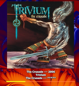

CAD RC4 Build 758+ (11Sep06)
- Morrir effect added (*)
- Improved notifier background support (**)
- Small bugs fixed
(*) there is no user interface to add or adjust the mirror effect (just the "skin.ini"); the mirror effect may depend on the case image itself; with the zip two skins using the mirror: "Cover Mirrored" and "Case Mirrored" (by Zaft). This is the first Mirror effect release and some procedures were not updated yet. Use it just for testing.
(**) the 2005 default CAD skin is back! :)
Download: http://www.closetosoftware.com/temp/cadrc4b758.zip
Mirror screenshot:
2005 screenshot:
Have fun! :)
