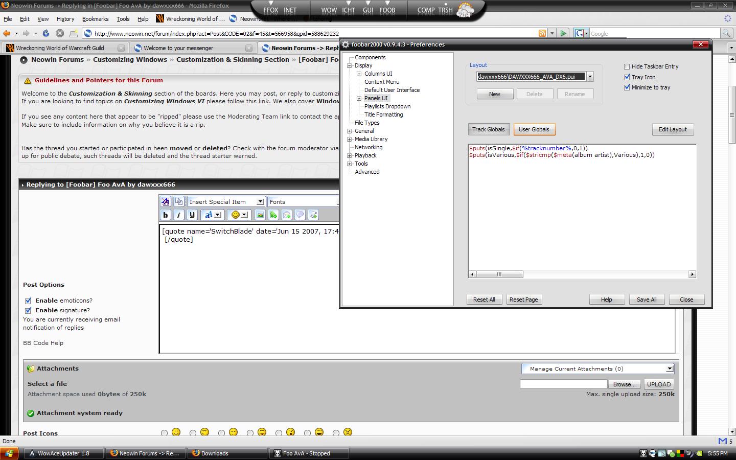

Saint Shiv Posted June 16, 2007 Share Posted June 16, 2007 your component folder should look something like this *attached* Link to comment Share on other sites More sharing options...
