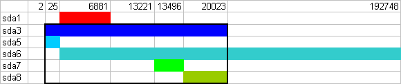

markwolfe Veteran Posted April 1, 2008 Veteran Share Posted April 1, 2008 (edited) You are messed up there! I don't know where to begin, exactly. Normally, partitions 1-4 are the "Primary" partitions, and you can define any of these as "Extended" to point to and contain four additional "Logical" partitions. hda (your IDE drive) looks ok. hda3 goes from 2-2613, and is defined as "extended" - hda5 is your logical NTFS partition in there, and it consumes the full space - (this could have just been a primary partition and be done with it, rather than go through all this) hda2 is a primary partition, flagged "bootable", and is also NTFS sda (your SATA) is seriously screwed up! sda3 is set up as "extended" from 2-20023. ok so far - sda5 is a logical partition in there, from 2-25, set up as EXT3 - sda1 is a primary partition, marked bootable but defined from 26-6881 inside the sda3 logical block region. - sda6 is a logical partition, from 6882-192748, which goes from inside the extended to outside of it - sda7 is also a logical, defined from 13221-13496 as swap. It is overlapping blocks with sda6 - sda8 is a logical partition, from 13497-20023, which falls neatly up to the end of the sda3 container, but overlaps sda6 I am wagering that what partitions you made were the wrong type/locations, and that sda is seriously screwed up. If you can, boot as a LiveCD, and rescue any important data you have there before it is gone. Then clear the entire drive/partitioning, and start over on it. EDIT: Here is a quick chart (not to scale) The red sda1 has no business (to my understanding) overlapping blocks with an extended. sda1 is primary, not logical. And you can see how sda6 breaks out of the container defined by blue sda3. As far as what should have been there, and what went wrong, it is a mystery to me. :ermm: Edited April 1, 2008 by markjensen Link to comment Share on other sites More sharing options...

+BudMan MVC Posted April 1, 2008 MVC Share Posted April 1, 2008 I like the chart Mark -- way to go the extra mile! As to where the problem started? "turned it back into unallocated space with acronis disk director in windows xp" "somehow messing with the merge tool" These types of tools are rarely needed by the average or even power users. Whatever OSes your using is more than capable of handling its own partitions, be it create them, delete them, format them, even resize them etc. hopefully you have no data on this disk that is critical.. You might be better off just blowing it all away and starting from scratch. Create whatever partitions you need with Windows, then in the unallocated space -- create whatever partitions you need using linux, etc. Good Luck Link to comment Share on other sites More sharing options...
markwolfe Veteran Posted April 1, 2008 Veteran Share Posted April 1, 2008 I like the chart Mark -- way to go the extra mile!... I find it much easier to quickly see problems with a simple chart than it is from the raw fdisk output. I was typing the numbers in Excel trying to wrap my head around the mess that drive was in, and looking at the output I could see it, but not as intuitively or as clear to describe with just words.I was more concerned about my factual accuracy, as far as only xda1-4 can be Primary, especially as I saw sda1 in the middle of the extended partition. And what I was explaining was at the edge of my firsthand knowledge from playing with computers. Finally, do you know of a simple app (in Linux, in particular) that parses the output of fdisk and can generate an image like the above? It seems with tools like LaTeX/postscript built-in, that generating a graph would be pretty trivial for someone experienced with a little bit of scripting. (alas, I lack that experience, but I might try a bit of self-learning on this if you aren't aware of a tool that already does this) Link to comment Share on other sites More sharing options...
