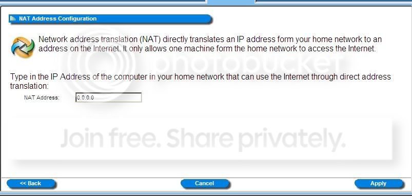

bhav930 Posted April 6, 2008 Author Share Posted April 6, 2008 i also dont know if you know anything about speedstream but when this first happened i got it to change to NAT2 but lost my internet connection (which now i dont care) but i chose the Address Translation on my setup page but now when i do my internet connection fails its usually set on the 3rd option,,but if i could even figure out how to make the 2nd option work again id be happy Link to comment Share on other sites More sharing options...
McSmiggins Posted April 6, 2008 Share Posted April 6, 2008 According to the manual, NAPT is exactly what you're after. Can you turn off DMZ and confirm the ports you've got forwarded to the PS3? From the list I've got, you should have: TCP: 80, 443, 5223, and Port Range 10070 - 10080 UDP: 3478, 3479, 3658, and 10070 Thanks Link to comment Share on other sites More sharing options...

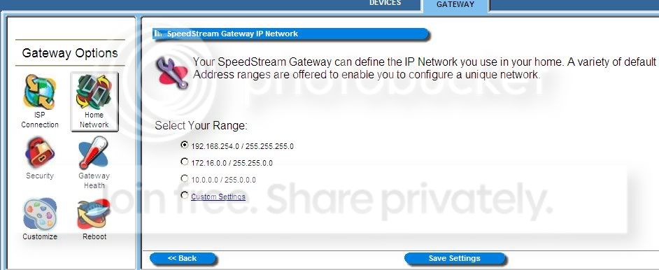

bhav930 Posted April 6, 2008 Author Share Posted April 6, 2008 ok, on my PS3 i have it set IP ADDY 192.168.254.2 Subnet Mask 255.255.255.0 Default Router 192.165.254.254 same for primary DNS and 2ndary here is ports Link to comment Share on other sites More sharing options...

McSmiggins Posted April 6, 2008 Share Posted April 6, 2008 Just to confirm, those forwarding settings are correct. And bobp makes a very good point. From reading a bit about the 6250, it does appear to have its problems, there's a few issues people have brought up on the internet when discussing it: There's reports of Port Forwarding not working with UPNP enabled. There's also mention that Port Forwarding doesn't like working unless the router hands out the IP address of the client via DHCP Have you got the "Gateway Health" option on the router setup screen? If so, turn off your PS3, open up the firewall logging section, note the last entry, turn on the PS3, wait for it to get a NAT2, then check the log for what's been blocked. Link to comment Share on other sites More sharing options...
