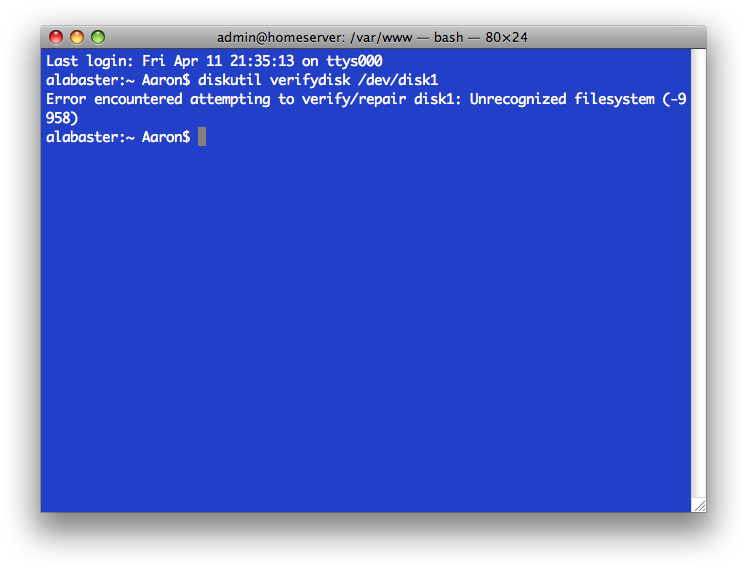

Aaron Veteran Posted April 11, 2008 Veteran Share Posted April 11, 2008 I have a WD Passport that I was using as my time machine disk, but all fo a sudden it is no longer mounting. I can take it and plug it into my linux machine, mount it, navigate it, but have no permissions to add or delete on it. Any thoughts? Is this a Time Machine issue or an OS in general? What sucks is that I can't even reformat it on another machine and start over... Link to comment Share on other sites More sharing options...

Aaron Veteran Posted April 11, 2008 Author Veteran Share Posted April 11, 2008 Well, kinda? It shows but, I cannot do anything to it. when I try to make a partition or anything else, it says something like "resource busy". I'm not at my mac so I can tell you exactly. Link to comment Share on other sites More sharing options...
giga Veteran Posted April 11, 2008 Veteran Share Posted April 11, 2008 Resource busy usually means in use--sure it's not mounted? A screenshot of disk utility would help though. Link to comment Share on other sites More sharing options...
Aaron Veteran Posted April 11, 2008 Author Veteran Share Posted April 11, 2008 Positive its not mounted, it isn't on the desktop nor showing in Finder. Time Machine also complains that there is no disk for it to use. I'll screenshot when I get home tonight. Thanks so far! Link to comment Share on other sites More sharing options...
giga Veteran Posted April 11, 2008 Veteran Share Posted April 11, 2008 Try and verify through terminal: To see the partitions: diskutil list I'd try mounting and unmounting it. If that doesn't work, do a verify to see if something's up with it. Link to comment Share on other sites More sharing options...

Aaron Veteran Posted April 13, 2008 Author Veteran Share Posted April 13, 2008 i have a feeling this is not good... Link to comment Share on other sites More sharing options...
CPressland Posted April 13, 2008 Share Posted April 13, 2008 well looks to me like the chipset inside the external hard drive is fraked. Try booting off your leopard DVD with the hard drive pluged in and run disk util on that just to make sure it's not just some weird bug in leopard Link to comment Share on other sites More sharing options...
giga Veteran Posted April 13, 2008 Veteran Share Posted April 13, 2008 Try reformat through terminal? Link to comment Share on other sites More sharing options...
CPressland Posted April 13, 2008 Share Posted April 13, 2008 Try reformat through terminal? I dont think that'll work because the hard drive is seen by the OS as 'busy' Link to comment Share on other sites More sharing options...
QuoVadam Posted April 13, 2008 Share Posted April 13, 2008 Try going to WDs website and downloading their latest firmware and drive management software. There have been many reports of new WD drives having issues with Leopard and Time Machine. I even had a MyBook drive stop working. Ever since I downloaded the new firmware, I've had no problems, and most reports are showing that the firmware update has fixed other peoples problems as well. Go to WDs website and give it a shot. http://support.wdc.com/download/index.asp Link to comment Share on other sites More sharing options...
CPressland Posted April 13, 2008 Share Posted April 13, 2008 Try going to WDs website and downloading their latest firmware and drive management software. There have been many reports of new WD drives having issues with Leopard and Time Machine.I even had a MyBook drive stop working. Ever since I downloaded the new firmware, I've had no problems, and most reports are showing that the firmware update has fixed other peoples problems as well. Go to WDs website and give it a shot. http://support.wdc.com/download/index.asp Hmm, hadnt heard of that but i'll install it onto my WD drives, thanks for the heads up. Link to comment Share on other sites More sharing options...
Aaron Veteran Posted April 14, 2008 Author Veteran Share Posted April 14, 2008 Thanks everyone for the help. Oddly enough, some combination of me unmounting. mounting, verify, etc with the diskutil in terminal and unplugging and re-plugging the drive and my system recognized teh drive. However, it needed to be initialized and i have had to wipe it out and reformat it. Bummer. What do you guys think? Is this a Time Machine/OSX issue or do you think it is my drive? As I said, I was able to take the drive and mount it on my linux machine (but not able to write due to permissions), so I think the drive might be fine. Link to comment Share on other sites More sharing options...
