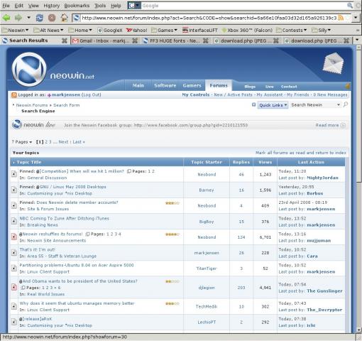

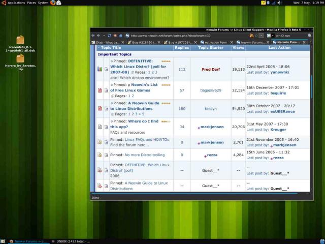

sirix Posted May 7, 2008 Share Posted May 7, 2008 I'm on Hardy, but this was a problem back when I tried out Gutsy too (with a less mature version of FF3). Here is a screenshot of FF3: Link to comment Share on other sites More sharing options...

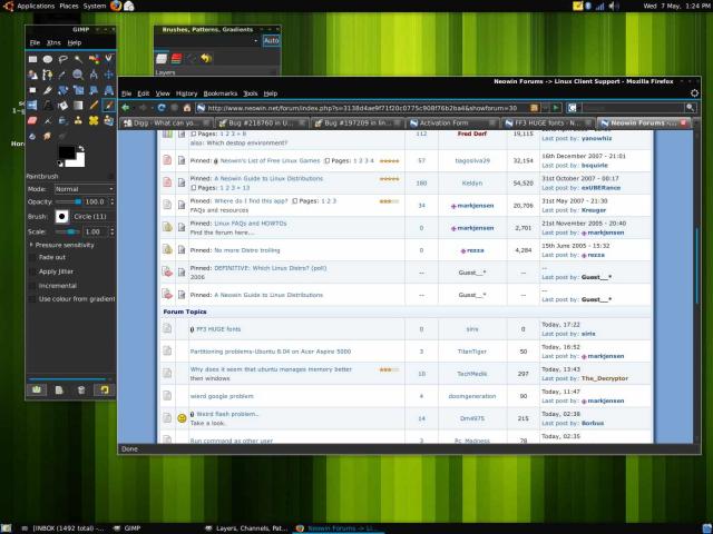

sirix Posted May 7, 2008 Author Share Posted May 7, 2008 Wow you guys are fast! Here is FF2 for comparison Link to comment Share on other sites More sharing options...
