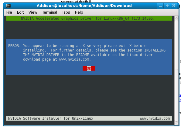

Berserk87 Posted May 30, 2008 Author Share Posted May 30, 2008 (edited) i think i fixed everything. i was running as root before, so i made a new user, and now it asks for a password, then installs. as fun as talking to myself has been, im going to bed :p another edit: i tryed installing the nvidia drivers again, but i got an error about X server, and to turn it of blabblbab. i took a screenshot to post, but then fedora crashed, i restarted and now it says i have no internet connection :blink: Edited May 30, 2008 by Berserk87 Link to comment Share on other sites More sharing options...
Berserk87 Posted May 30, 2008 Author Share Posted May 30, 2008 heres the screenshot, gnight. Link to comment Share on other sites More sharing options...
markwolfe Veteran Posted May 30, 2008 Veteran Share Posted May 30, 2008 Yeah, in Fedora you have to do several things manually that Ubuntu will do with just a couple of clicks. For installing the nVidia file, if you use the .run file, you need to kill X to run it. You can do that by specifying init 3 as root in a terminal to force the system into runlevel 3 (text mode only - no X). Then you can run the file. However, since you are installing the driver manually (and it is matched to the kernel), every time a new kernel is released and you install it with yum, your video will break and you will have text mode only until you manually install the matching new nVidia file. It kind of sucks doing it that way. The way I recommend is to use yum to install your video driver. That way when yum sees a new kernel available, it will automatically also get the matching nVidia driver for you. No text mode on reboot. No mucking around with manually running files as root. (Y) There is a procedure here: http://www.fedorafaq.org/#nvidia It basically just has you add the "livna" repository to your yum configuration. Livna is where the nVidia drivers are stored, so if yum is allowed to look there, it will see them and install. I highly recommend using this method. :yes: Link to comment Share on other sites More sharing options...
Borbus Posted May 30, 2008 Share Posted May 30, 2008 What you have to do is stop gdm because gdm will keep starting X again even if you kill it (ctrl-alt-backspace). So switch to a tty like tty1 by pressing ctrl-alt-F1. Well actually I have no idea how Fedora works... but first find out how to stop a daemon and then stop gdm and then run the the nvidia setup from the tty. Or you can use envy if it is available for Fedora and that can do it without having to switch gdm off (but you will need to restart X). Link to comment Share on other sites More sharing options...
markwolfe Veteran Posted May 30, 2008 Veteran Share Posted May 30, 2008 ... So switch to a tty like tty1 by pressing ctrl-alt-F1.... Switching to a TTY (Fedora, Ubuntu, Slackware, what-not) will not stop X. X will still be running on whatever session it was started on. CTRL+ALT+F7 (typically) will pop you back to displaying X. You need to just shut it down with the init 3 command. Link to comment Share on other sites More sharing options...
Borbus Posted May 30, 2008 Share Posted May 30, 2008 Yes but when you stop gdm that will kill the X server that gdm started. Ctrl-alt-backspace does shut down X, but something like gdm just spawns a new X automatically. Switching to run level 3 (at least from my Debian understanding) would just stop any daemons that are supposed to be stopped when entering this run level (such as gdm) so it does basically the same thing. Link to comment Share on other sites More sharing options...
markwolfe Veteran Posted May 30, 2008 Veteran Share Posted May 30, 2008 I never said CTRL+ALT+[backspace]. As you stated, that would just trigger a restart of X. I said init 3 That will shut down X, and put you into runlevel 3. It will not trigger a restart of x/k/gdm. With X shut down, you would be able to run the nVidia .run file (which I already recommended against). Link to comment Share on other sites More sharing options...

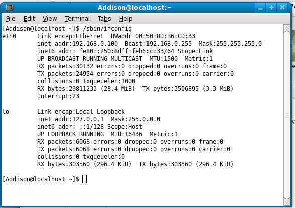

Berserk87 Posted May 30, 2008 Author Share Posted May 30, 2008 im trying to install vlc player , and it keeps telling me "cannot install without a network connection" which i obviously have. at the same time everytime i open firefox, its opening in "offline mode" Link to comment Share on other sites More sharing options...
markwolfe Veteran Posted May 30, 2008 Veteran Share Posted May 30, 2008 /sbin/ifconfig You can also use Fedora's network "control panel" to see if your card is listed and active. Do you use DHCP? Link to comment Share on other sites More sharing options...
Berserk87 Posted May 30, 2008 Author Share Posted May 30, 2008 yes, i do. network card shows as active, but the add/remove software keeps giving me the "cannot so and so while offline" Link to comment Share on other sites More sharing options...
markwolfe Veteran Posted May 30, 2008 Veteran Share Posted May 30, 2008 What is the output of the /sbin/ifconfig command? Link to comment Share on other sites More sharing options...
Berserk87 Posted May 30, 2008 Author Share Posted May 30, 2008 Link to comment Share on other sites More sharing options...
markwolfe Veteran Posted May 30, 2008 Veteran Share Posted May 30, 2008 The "UP" tells me the interface is activated. It has what appears to be a valid IP address assigned by your router and I see packets sent and received. Can you ping your router? It is probably address 192.168.0.1, based on what I see your IP is set to. Link to comment Share on other sites More sharing options...
Berserk87 Posted May 30, 2008 Author Share Posted May 30, 2008 the culprit was "network manager" seems to be flawed currently. i opened services, disabled it from startup and stopped it, now vlc is installing :) Link to comment Share on other sites More sharing options...
