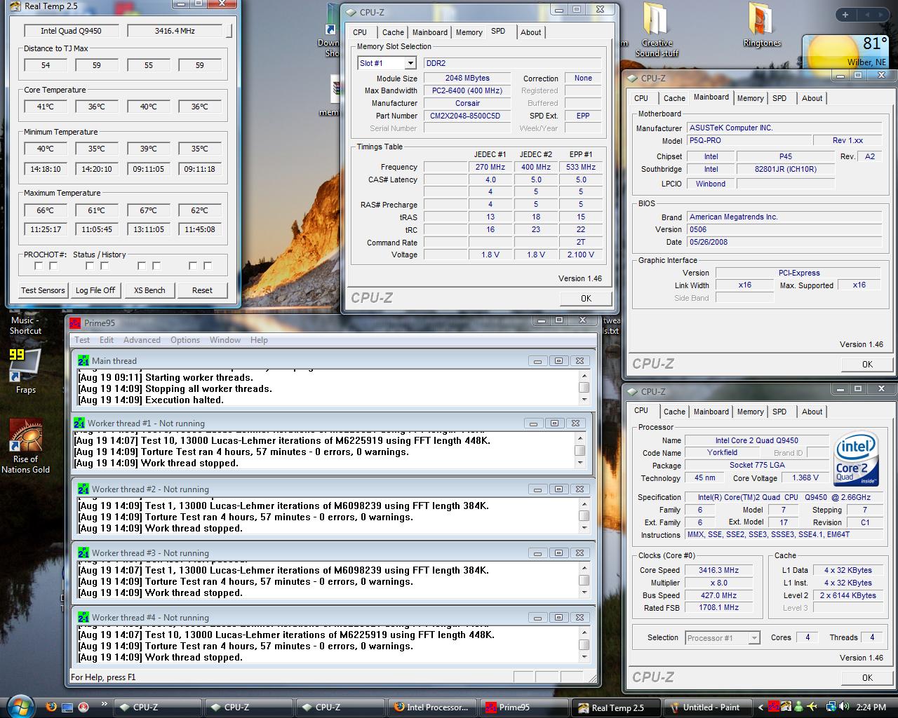

The memory timings and voltage is where i get in over my head a bit. I don't want to fry anything...below are some CPU-z screens, perhaps you guys can help me figure out if the timings are correct or not (i didn't see anything on the package when i got the memory).
The Q9450 was cooled with a Noctua NH-U12P and my max temperatures never reached over 66C while using Prime95. I know it wasn't 8+ hours with Prime95 (only 5) but I figured it was stable enough because most of my cores were actually decrease a bit in temperature after that long.
This was my first ever personally built computer as well as overclock. I had the vcore set to 1.4 in the BIOS but idle at the desktop it is showing 1.36 in my CPU-Z screens. This was just the initial overclock as I'm not really sure what I want to increase for now. I think this is capable of hitting 3.5GHZ, but it would take more time and some advise.
My ram isn't at its rated speed (PC8500) but Gwai said don't worry about it because he said it shouldn't matter.
Decrease in temperature != stability. ;) I'll add you in, but you won't be confirmed stable.
Also, RAM rated frequency only indicates that, it's rated for that frequency. You're free to run it slower or faster if you please, neither will have a huge impact on your performance. Pushing higher RAM frequencies than the processor FSB doesn't bring real gains and ends up really just being an extra strain on your RAM and board. That and I doubt you'd hit 533 FSB with your chip. ;)

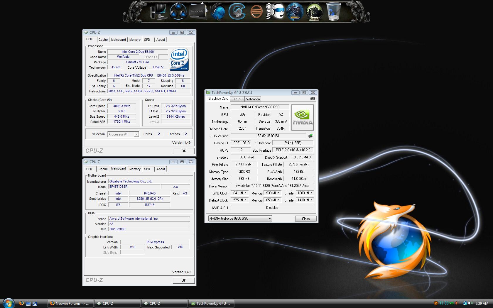

Processor: E8400 @ 4.05 GHz (24/7 computer - only goes off to reboot, +gaming & daily use).
Stepping: C0
Week / Code: N/A - Bought all hardware from Fry's Electronics ~6days ago, Processor doesn't come with the box.
vCore: 1.269v (idle) & same under 100% load, doesn't budge.
CPU Cooling: Cooler Master Hyper TX-2.
Motherboard: GA-EP45T-DS3R - BIO's Version: F2 (Released - 06/18/2008)
Operating System: Windows Vista SP1 Home Premium (32bit)
RAM: Patriot 1066 DDR3 PC3-8500 (2x 1GB Sticks) - Manual Set Timings: 7-7-7-20 (1:1 FSB:RAM Ratio) 2.00D Multi.
Temps under 64c, 12 hours Prime95 stable, 2-3 cycles 3DMark06)
CPU-Z Validation: http://*malware domain*/show_oc.php?id=484937
Screenshot:
Got you added.
Can you confirm that's the frequency your RAM is running at? The "memory" tab in CPU-Z will tell you that.
Also, for future reference, the week and code can be found on the actual processor die. Doesn't need to be read off of the box.
