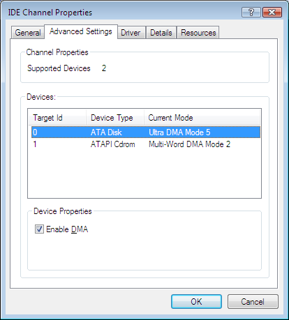

roadgeek9 Posted September 27, 2008 Author Share Posted September 27, 2008 Ok was just making sure :)try this.. http://ubuntuforums.org/showthread.php?t=793726 Does that help? My laptop's BIOS is a real disgrace. It has next to no options. In Windows, here are my IDE controller settings... But I do remember reading earlier today that you could put in the option "ide=nodma" at boot to solve the problem. Would that help? Link to comment Share on other sites More sharing options...
