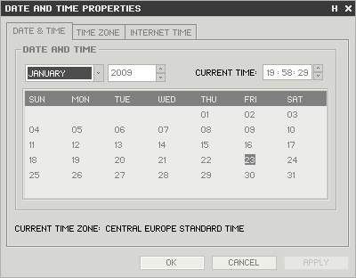

dis Posted January 23, 2009 Share Posted January 23, 2009 (edited) i was able to do some minor changes in the timedate.cpl. here it is: calendar HACK by des (only system colors can be used.) hex 6A01 @ [0x14A6] weekdays name [in 1-2-3 words] > 6A01 ..02 or ..03 hex 6A03 @ [0x140F] weekdays name bg color > 6A00 - 6A?? hex 6A13 @ [0x141B] weekdays name text color > 6A00 - 6A?? hex 6A03 @ [0x1189] weekdays bar bg color > 6A00 - 6A?? hex 6A08 @ [0x11C6] days text color > 6A00 - 6A?? hex 6A05 @ [0x11AA] days text bg color > 6A00 - 6A?? hex 6A05 @ [0x1142] the whole calendar bg color (original white) > 6A00 - 6A?? hex 2000 @ [0x111E] 2digit day numbers (if 3000) (you can resize the calendar with reshacker) edit: i know a little bit offtopic. but... Edited January 23, 2009 by dis Link to comment Share on other sites More sharing options...

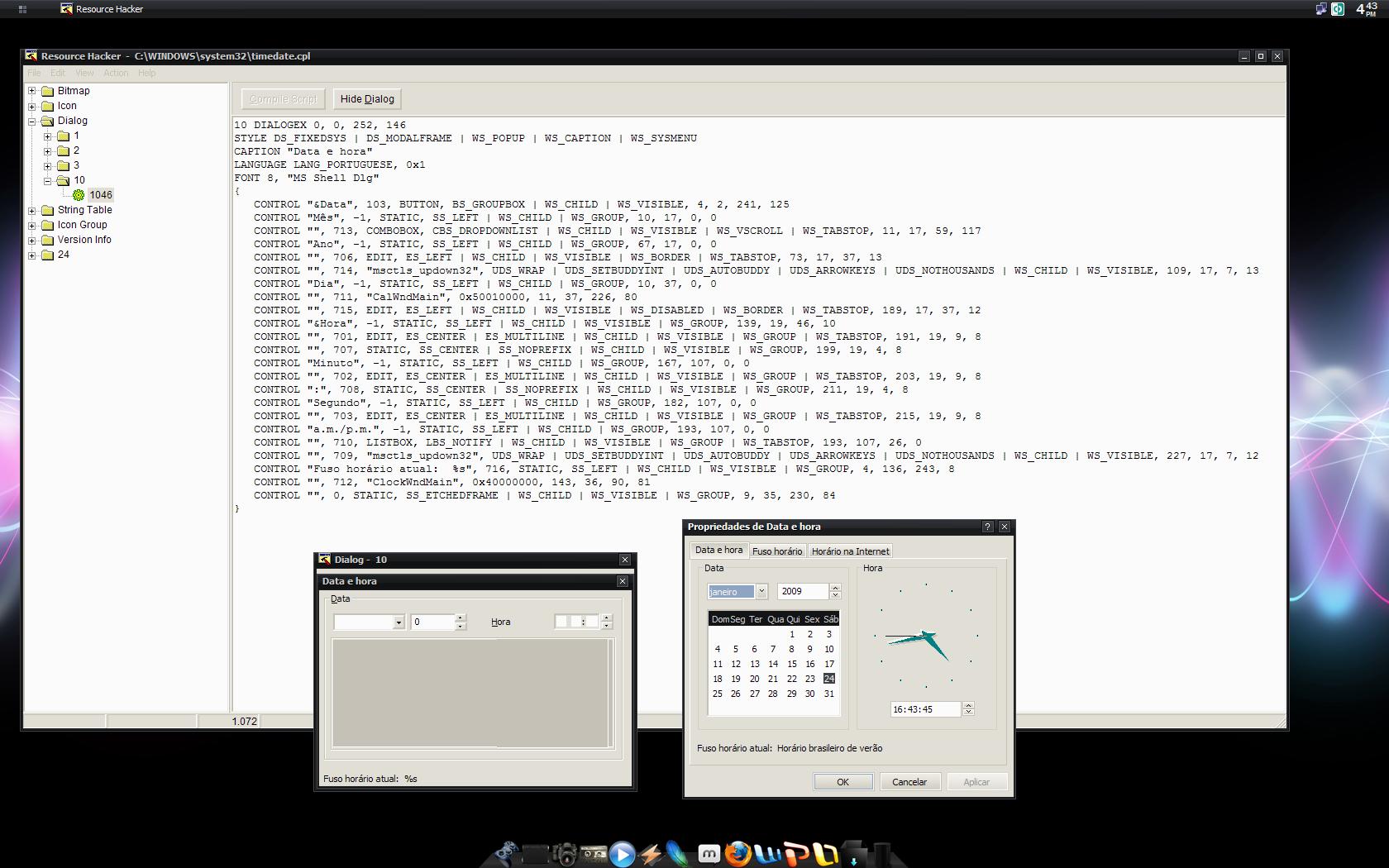

Kamnitzer Posted January 24, 2009 Share Posted January 24, 2009 (edited) ok... so, i was able to change the number of chars on the day's names, but couldnt change de visual of the window.. in reshack the file is changed, but when i open the window it remains as the original form. tried to change with replacer, but failed too... any ideias ? here is a SS to clarify what I'm talking about: Edited January 24, 2009 by Kamnitzer Link to comment Share on other sites More sharing options...
dis Posted January 24, 2009 Share Posted January 24, 2009 (edited) change the dialog 1 too. because dialog 1 and dialog 10 is the same. but don't forget to change the code's first line if you copy the code from the dialog 10. 1 DIALOGEX 0, 0, 252, 146 = dialog 1 10 DIALOGEX 0, 0, 252, 146 = dialog 10 and in my code, the last one: CONTROL "", 0, STATIC, SS_ETCHEDFRAME | WS_CHILD | WS_VISIBLE | WS_GROUP, 9, 35, 230, 84 -> just delete it if you dont want. i just added this to have a border around my calendar. Edited January 24, 2009 by dis Link to comment Share on other sites More sharing options...

Kamnitzer Posted January 24, 2009 Share Posted January 24, 2009 change the dialog 1 too. because dialog 1 and dialog 10 is the same.but don't forget to change the code's first line if you copy the code from the dialog 10. 1 DIALOGEX 0, 0, 252, 146 = dialog 1 10 DIALOGEX 0, 0, 252, 146 = dialog 10 and in my code, the last one: CONTROL "", 0, STATIC, SS_ETCHEDFRAME | WS_CHILD | WS_VISIBLE | WS_GROUP, 9, 35, 230, 84 -> just delete it if you dont want. i just added this to have a border around my calendar. thanks man ! that worked !!! =)) Link to comment Share on other sites More sharing options...
