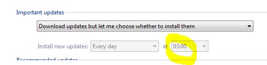

Sparky Marky Posted January 15, 2009 Share Posted January 15, 2009 3am is also the default time for windows update to run, have a look and change the time if it is still 3:00. Link to comment Share on other sites More sharing options...
