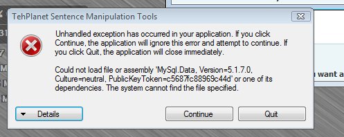

How do I compile a vb.net program that utilises Mysql Connector/Net 5.1 so that it can be run from an executable file without install on a computer without the drivers installed.
I know that you can get the executable program from the debug folder, but on running the executable program on a machine without the mysql connector drivers installed this error came up:post-262506-1234168043.jpg.

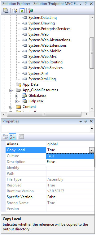

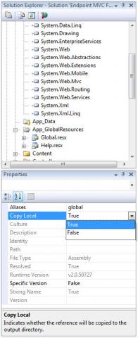

For libraries outside of the reach of the standard .NET BCL (Base Class Library), and official extensions (like ASP.NET Extensions, MVC etc.), I never assume that they will be installed in the GAC.
To avoid this in future, when you include a reference to a 3rd party, set the CopyLocal property of the referenced assembly to True:
