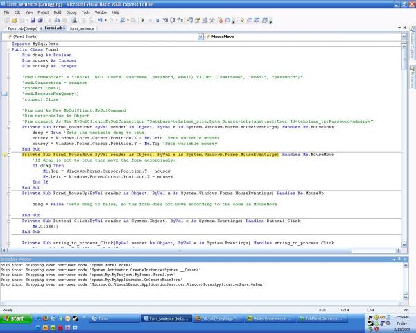

0 ~Matt~ Posted February 13, 2009 Author Share Posted February 13, 2009 It starts on the first line and I cant drag the arrow anywhere as shown in the image: Link to comment Share on other sites More sharing options...
0 Antaris Veteran Posted February 13, 2009 Veteran Share Posted February 13, 2009 Keep pressing F11 to step through the code, don't move the arrow itself unless you need to go back. Basically keep stepping through until you find what is taking the longest. Link to comment Share on other sites More sharing options...
