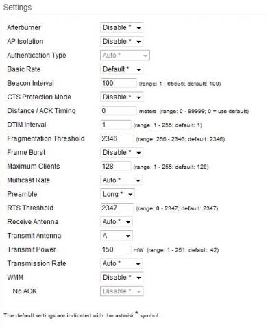

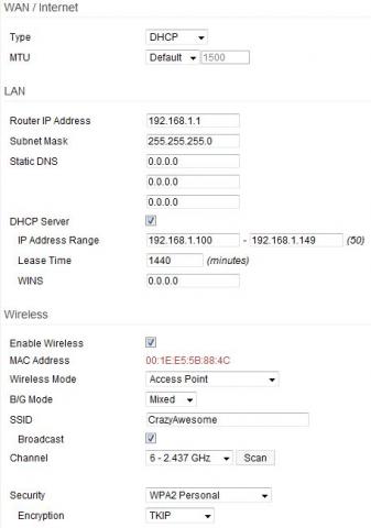

»X« Posted February 12, 2009 Author Share Posted February 12, 2009 Heres what I got Link to comment Share on other sites More sharing options...
Sartoris Posted February 13, 2009 Share Posted February 13, 2009 As far as I have heard, the Xbox 360 wireless adapter does NOT support WPA2. Link to comment Share on other sites More sharing options...
P!P Posted February 13, 2009 Share Posted February 13, 2009 LOL. Yeah, the Xbox/ Xbox 360 adapters don't work with WPA2. Don't be dissin' Tomato. Link to comment Share on other sites More sharing options...
Fuzzymath Posted February 13, 2009 Share Posted February 13, 2009 "But the box says it does" The box lies. Preemptive. Link to comment Share on other sites More sharing options...
»X« Posted February 13, 2009 Author Share Posted February 13, 2009 Why is there a WPA2 greyed out option in network settings for the 360? If it doesnt support it, remove it? Link to comment Share on other sites More sharing options...
koftheworld Posted February 13, 2009 Share Posted February 13, 2009 I had this problem when I was first setting up the official 360 wireless adapter. I didn't realize that it didn't support WPA2 (even though it is listed, but grayed out) until I looked it up online. I switched my router's security protocol to WPA, and the wireless adapter worked right away. Why is there a WPA2 greyed out option in network settings for the 360? If it doesnt support it, remove it? I would venture a guess that it may be enabled with a future update...that's just my opinion though. Link to comment Share on other sites More sharing options...
