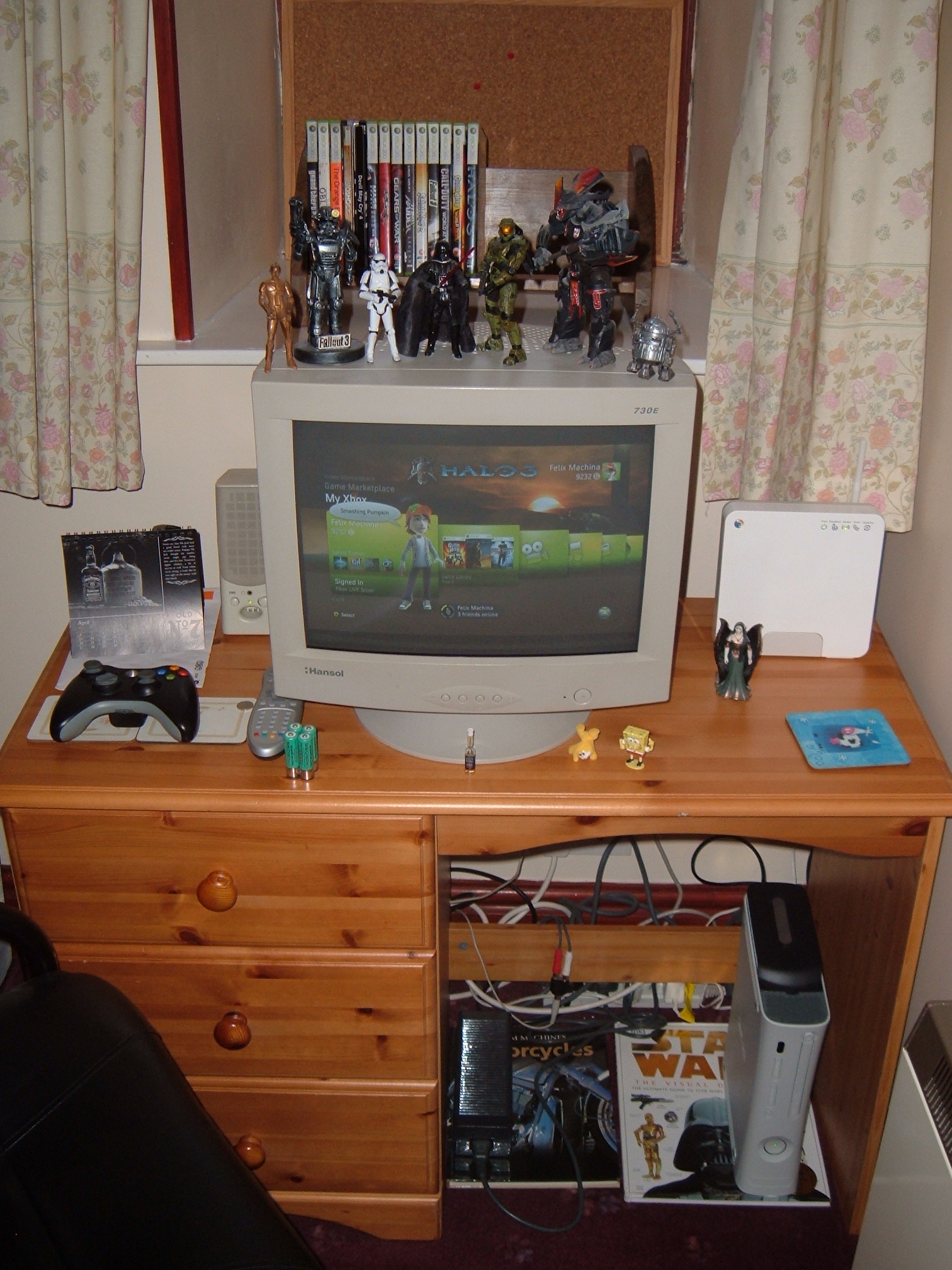

Smashing Pumpkin Posted April 13, 2009 Author Share Posted April 13, 2009 Managed to get 2 hubs for ?12.20 including delivery - crazy! Thought I might as well get 2 considering the price so I can keep the Netgear as it is so I've got a backup if needed. Looking fwd to trying this! I'm glad that you're gonna give it a go, hope it works out well for you:)) You know, personally, I'd fork out and get the adaptor. It must look damn ghetto 'LOOK MY 360 ARE PLUGGED INTO PHONE!!!' Yeah, it looks reeeeeally 'ghetto' White with green lights, totally doesn't go with the 360! Link to comment Share on other sites More sharing options...
Plarkster Posted April 13, 2009 Share Posted April 13, 2009 I'm glad that you're gonna give it a go, hope it works out well for you :) Yeah, it looks reeeeeally 'ghetto' White with green lights, totally doesn't go with the 360! I like the look of the home hubs actually - is that the 1.5 version in the picture? I've got a 1.0 and 1.5 on the way I think - planning on unlocking the 1.0 to connect to the internet and have the 1.5 connected to the 360. Have you got 2 of the same version or 2 different ones? Link to comment Share on other sites More sharing options...
Smashing Pumpkin Posted April 13, 2009 Author Share Posted April 13, 2009 It's a white 1.5 in the picture. Excuse all the cabling etc. As you can see I'm more bothered about value and functionality than purdiness, hence the CRT, PC speakers, Black 120GB HDD and leaving out of the audio connection to 360 to plug my mp3 player into (it's Sony so won't work with the 360!). Downstairs I have a 1.0 Black Hub, since we're on BT I didn't need to change any firmware or anything. Although the guide recommends you do I found that it worked without :iiam: (wanted an excuse to use that emoticon for ages). Although it does work very well I have experienced occaisional periods of inexplicable lag when playing Halo 3 online (the only game I've tried so far). Though this may just be due to the distance/number of walls that are between the 2 Hubs. If we wern't renting this house (hence the curtains in the picture!!!) I would have laid out a load of cable in a flash. Link to comment Share on other sites More sharing options...
