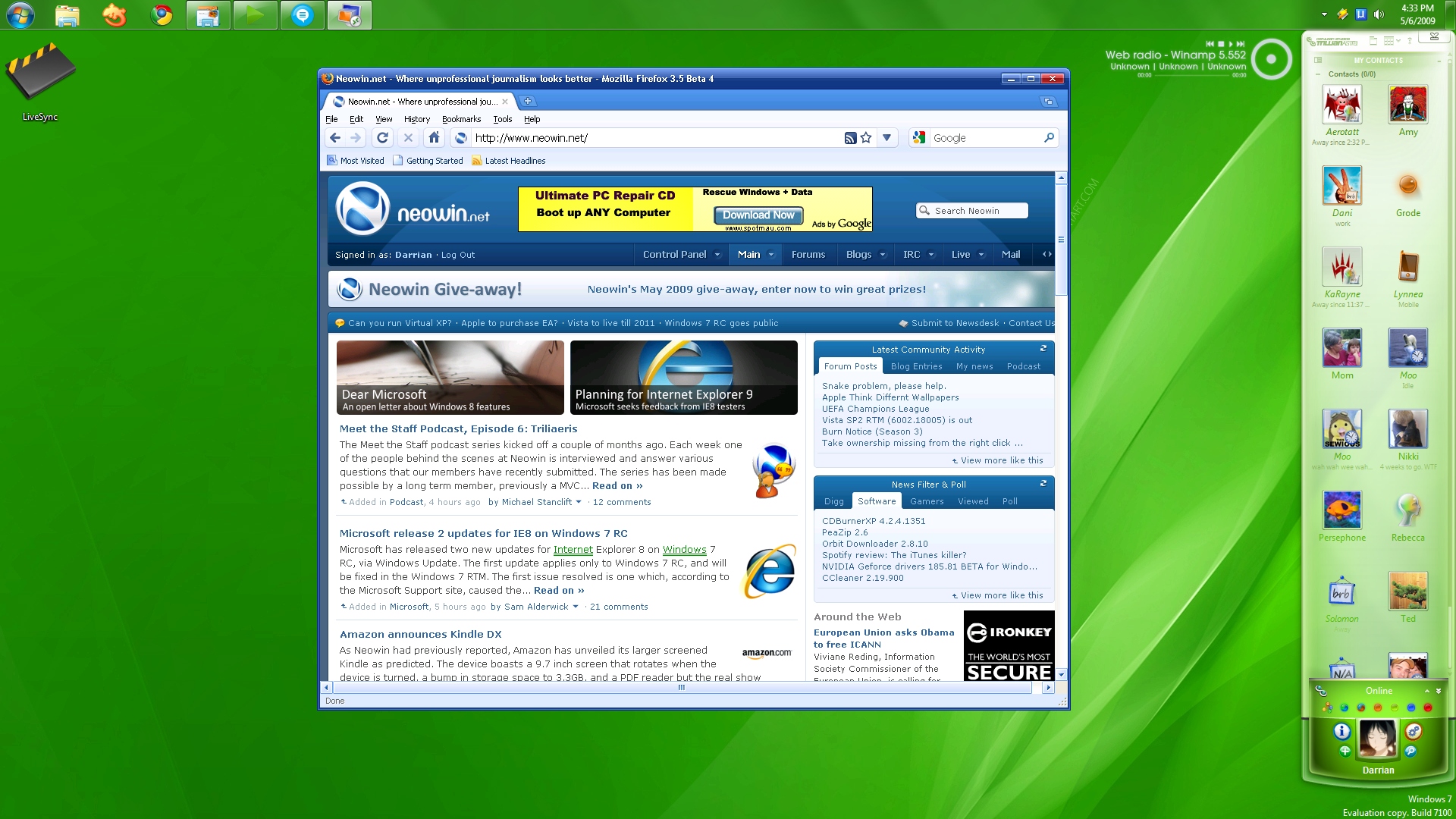

Darrian Posted May 5, 2009 Share Posted May 5, 2009 I am a troll because...you agree with me? Damn, that's a first! Well, I don't agree with you. When XP x64 came out I switched and I haven't used a 32-bit OS since (unless you count Haiku in a VM for a few minutes every few months to check on its progress). Running a 64-bit VM for XPM would be perfectly fine for me, if it were possible, because I would be using it for applications that only work on XP, not on applications that only work on a 32-bit OS. Which pretty much means I won't be using it, since all my apps work on Windows 7 x64. I was tempted to try it out to run The Chronicles of Spellborn, which does not work on 7 due to some anti-cheat software it tries to run being suppressed, but it doesn't sound like XPM is a viable choice for gaming. Instead I'll just have to wait for them to update the client so it can run. Still, the geek in me that wants to try out XPM simply because I can. I'd really like to know if you can patch the uxtheme.dll in the VM and change themes, so that when you open an app in XPM it would use the window border of the 3rd party theme and not Luna. I installed XPM but recieve an error when trying to launch virtual PC... i cant remember what it was at the moment but i dont think you can run it at all unless your processor supports 'hardware virtualisation' Yes, that was well documented when XPM was announced. Your CPU must support virtualization and it must be enabled in your BIOS. Link to comment Share on other sites More sharing options...

Darrian Posted May 6, 2009 Share Posted May 6, 2009 I couldn't resist playing with it. Now if I could only figure out how to enable 24-bit or even 32-bit color. Nobody seems to want to share exactly what they've done to accomplish it, and my search for answers has just led me around one gigantic circle jerk. Link to comment Share on other sites More sharing options...
