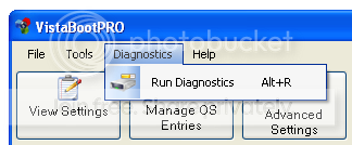

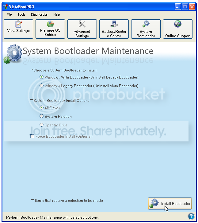

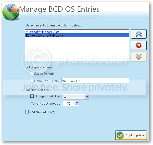

bodmas Posted May 4, 2009 Share Posted May 4, 2009 yes it will work but after win7 you can't install xp running setup file from your HDD. for this purpose you have to boot install from cd or thumb drive but always remember to install on another drive (not on xp drive). once you will complete the install of xp you will see that win7 from boot menu has been disappeared. No problem here. Now search for "vista boot pro" tool. it is very nifty tool. install this on xp (obiviously as at present you have only xp). prior to this you need to first install MS .net framework 2.0 or later version. now when u have installed vista boot pro. so run this program. now install the boot loader : step wise: step-1. step 2. now run diagnostic tool : step-3. now click on "manage OS entries" tab Now reboot and both OS have now been entered into your boot record. select as per your choice to enter into preferred os. Please not that the above pictures were taken when xp installed after vista. but since kerneal is almost same in both vista and win7 so it will sure work in windows 7 too. Link to comment Share on other sites More sharing options...
