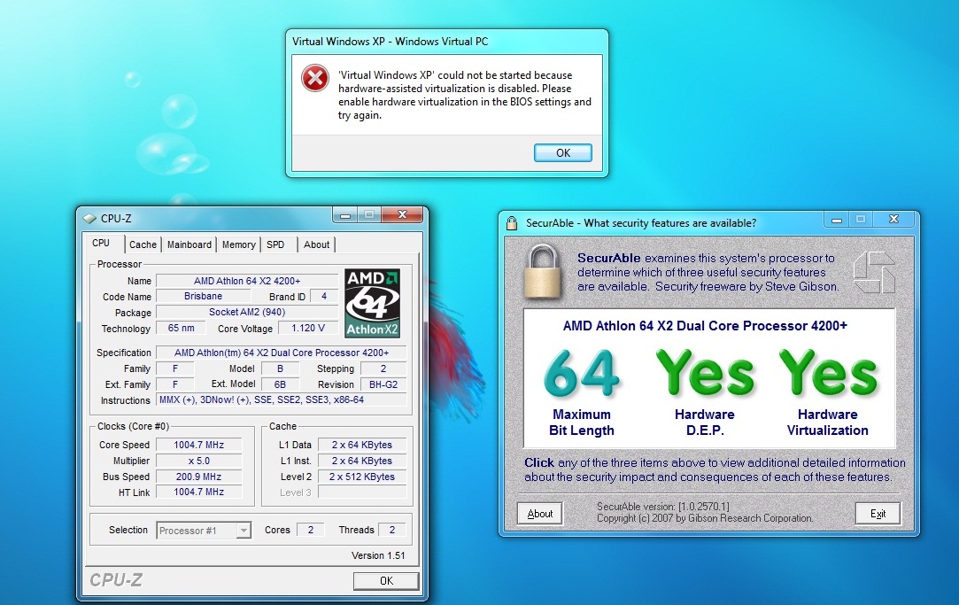

Southern Patriot Posted May 4, 2009 Share Posted May 4, 2009 .... these two screenshots say otherwise. What the hell is going on here?? I'm about ready to pull out my hair (what little bit I have left) with this stupid machine. Link to comment Share on other sites More sharing options...
jamesVault Posted May 4, 2009 Share Posted May 4, 2009 you need to power off and on your PC after you have enabled the VT in the BIOS. Rebooting is not enough Link to comment Share on other sites More sharing options...
Southern Patriot Posted May 4, 2009 Author Share Posted May 4, 2009 you need to power off and on your PC after you have enabled the VT in the BIOS. Rebooting is not enough I have had it enabled since I got the machine and it has been powered off many times. That's not the issue here, unfortunately. Any other ideas? Link to comment Share on other sites More sharing options...
Ozrics Tentacle Posted May 4, 2009 Share Posted May 4, 2009 I have had it enabled since I got the machine and it has been powered off many times. That's not the issue here, unfortunately. Any other ideas? Same issue here. Ironically, if I hard boot, verify BIOS and SAVE BIOS changes (there were none!), after booting it WORKS!!! Until I reboot.... without going through the BIOS. Link to comment Share on other sites More sharing options...
Southern Patriot Posted May 4, 2009 Author Share Posted May 4, 2009 Same issue here. Ironically, if I hard boot, verify BIOS and SAVE BIOS changes (there were none!), after booting it WORKS!!!Until I reboot.... without going through the BIOS. Nope, that didn't work here. I'm starting to think the motherboard in this machine (or at least the BIOS) has some really screwy limitations. When I have 4GB installed, I have random problems with my PCI WiFi card and my PCI USB port card (sometimes they refuse to show up, sometimes I get bluescreens related to the WiFi driver). All indications point to the system not properly mapping the PCI cards outside of the 4GB memory range. This is most likely because this motherboard originally came with a 32-bit processor. The current version of the BIOS that is installed supports 64-bit processors and >4GB of RAM, but I'm thinking it is still buggy. I'm going to look at replacing the motherboard next with one that actually works right in a 64-bit environment. Link to comment Share on other sites More sharing options...

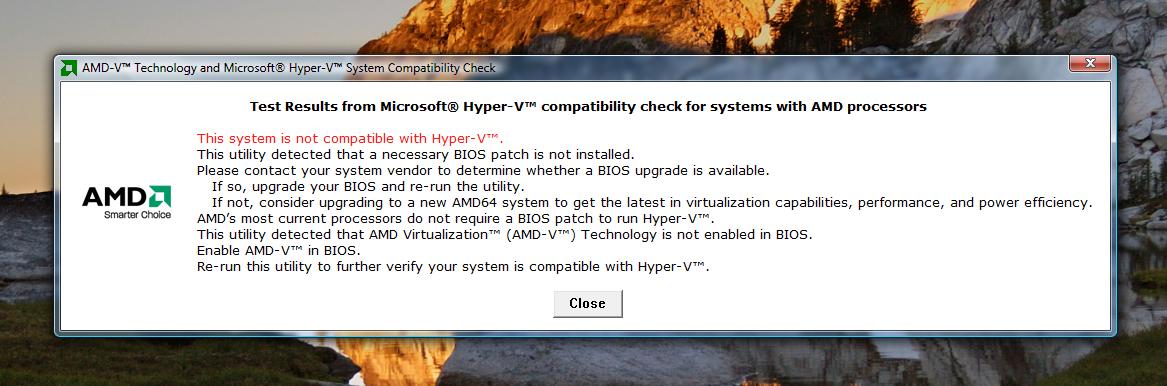

Southern Patriot Posted May 5, 2009 Author Share Posted May 5, 2009 (edited) Disable the Viertualisation option in the bios and then restart the PC and then renable it and then restart the PC. Tried that too. Even with the absolute latest version of the BIOS for this motherboard (the Foxconn BIOS, not the crappy eMachines BIOS). It turns out that Securable doesn't actually check that the SYSTEM supports virtualization, only that the model of CPU does. AMD has a utility that actually checks the BIOS, and it reports that it isn't enabled. Oh well, time for a new motherboard. I doubt many businesses buy emachines, and since this feature is not really intended for the home user because, as it is right now, most applications that home users use are already compatible with Vista/Win 7. I have a feeling that this little problem isn't limited to eMachines (yeah, it seems to be a pretty prevelant problem, if this Google search is any indication: http://www.google.com/search?q=amd+hyper-v...amp;startPage=1 ). Either way, they should have made this use virtualization if the system supported it (for best performance) but revert to not using it if the system didn't support it. Edited May 5, 2009 by roadwarrior Link to comment Share on other sites More sharing options...
