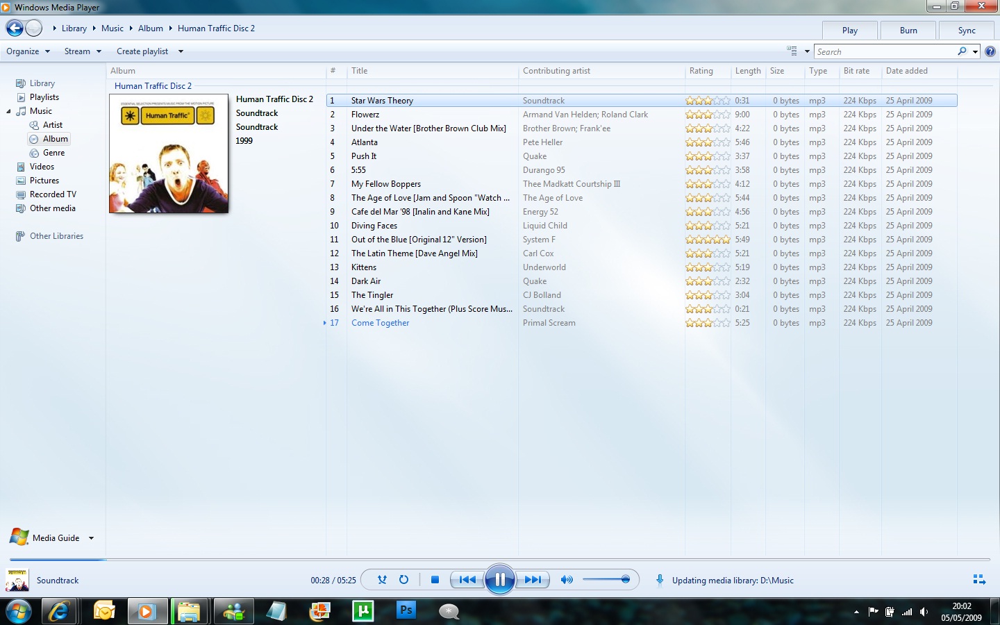

Examinus Posted May 5, 2009 Share Posted May 5, 2009 Does WMP report files as being 0 bytes for anybody else? It did it with me in 7000 and I hoped it would be fixed, but hasn't. Is it a known bug? Some songs are reported as being the correct size, but the vast majority are 0. Link to comment Share on other sites More sharing options...

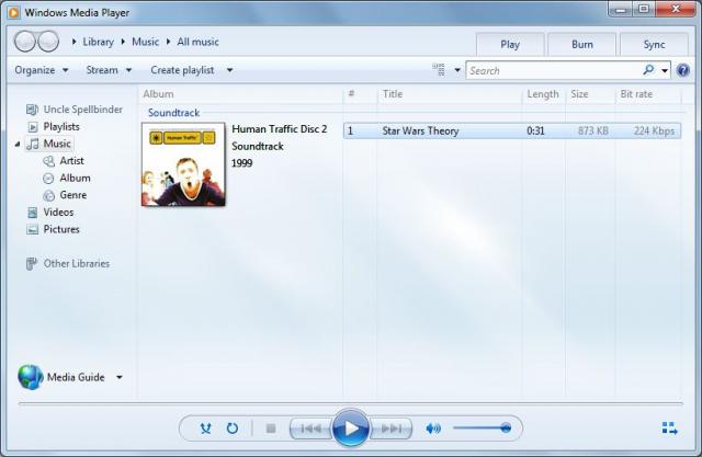

Examinus Posted May 7, 2009 Author Share Posted May 7, 2009 Hi, sorry for the late reply...I didn't have a computer last night. I don't know what Neowin's policy on uploading music is, but I've attached an MP3 that is reported at 0 bytes in WMP but is in fact 873KB (I presumed the actual size wouldn't matter). I hope it gives you some idea what's going on! 01_Human_Traffic___Star_Wars_Theory.mp3 Link to comment Share on other sites More sharing options...

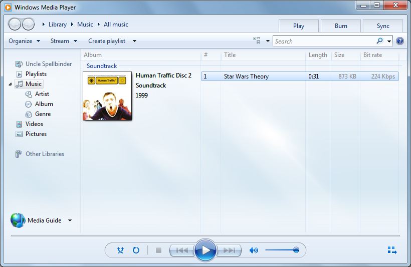

UncleSpellbinder Posted May 7, 2009 Share Posted May 7, 2009 @ Examinus Used your MP3 and it seems to be an issue on your end as the file shows correct size for me. I'm using Win 7, 7100 RC (64-bit) Link to comment Share on other sites More sharing options...

Examinus Posted May 26, 2009 Author Share Posted May 26, 2009 Gah! The problem's come back now, seemingly after this happens. Link to comment Share on other sites More sharing options...
