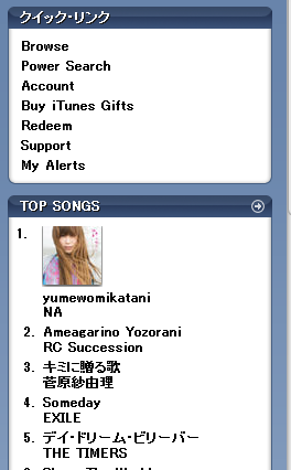

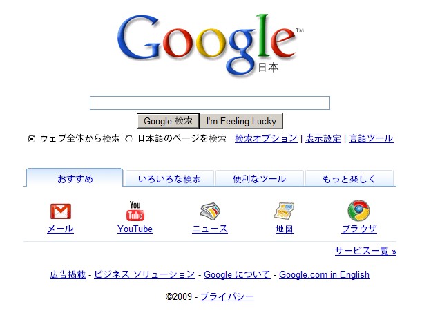

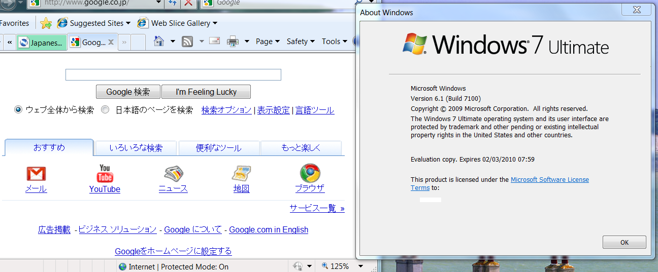

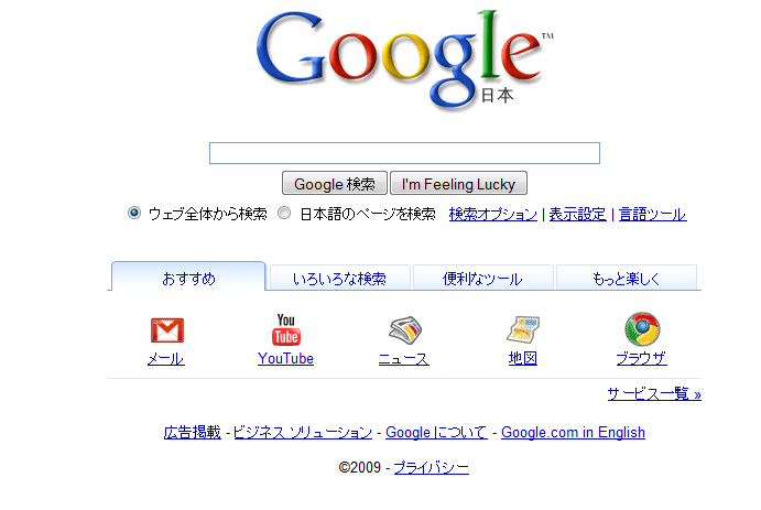

TOKYO RAIN Posted May 6, 2009 Author Share Posted May 6, 2009 give some more details!!! Well I came from Mac OS X where japanese fonts were very smooth and nice... On a default setup for 7100 RC it looks the same as Japanese fonts look under XP and I thought they were kinda fixed up in Vista (I think maybe as a seperate language pack download in windows update?). Have a look at these examples. Is this the way it should look normally? Link to comment Share on other sites More sharing options...

The_Decryptor Veteran Posted May 6, 2009 Veteran Share Posted May 6, 2009 It's because they have embedded bitmaps, they're rendered straight to the screen without hinting or antialiasing or all the other stuff normal outline fonts go through. There is a font in Vista and 7 that doesn't use them though, it uses normal hinting and antialiasing like the other fonts, it's called Meiryo. Link to comment Share on other sites More sharing options...
TOKYO RAIN Posted May 6, 2009 Author Share Posted May 6, 2009 It's because they have embedded bitmaps, they're rendered straight to the screen without hinting or antialiasing or all the other stuff normal outline fonts go through.There is a font in Vista and 7 that doesn't use them though, it uses normal hinting and antialiasing like the other fonts, it's called Meiryo. Thanks for this. I had a look at that font and it does indeed look nice but for the life of me I can't figure out how to tell windows "when rendering japanese use these fonts instead". Is it application specific? Link to comment Share on other sites More sharing options...

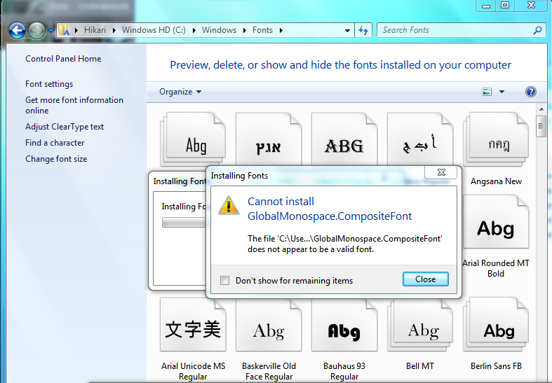

Lord Ba'al Posted May 8, 2009 Share Posted May 8, 2009 Ba'al I'm going to make sweet love to you haahha. I'm afraid I'll have to decline your offer on this :pinch: This worked and I'm very very happy with the way everything looks now. Thank you so much for this.Just as an FYI, I ran the regedit but the fonts wouldn't copy into C:\Windows\Fonts and I've attached the error. I rebooted anyways and it seemed to work regardless. The regedit file does the major part of the work, but not all, that's why you need to overwrite the Global*.* files. If you open the Fonts folder and drag them over it, Windows thinks you want to install them as fonts, which won't work of course. You'll have to copy them using the command line window or using a separate install of Windows. To copy them using the command line: Go to All Programs > Accessories, right-click on Command Promt > Run as Admin Change into the directory in which you have unpacked the Global*.* files, e.g.: cd c:\download\FontFixLordBaal Then enter the following command: copy global*.* c:\windows\fonts A prompt will appear asking you if you want to overwrite fonts. Simply press a (for 'all'). It will then tell you "4 file(s) copied.", reboot once more and you're done :cool: I've attached a new zip file with updated instructions. FontFixLordBaal.zip Link to comment Share on other sites More sharing options...
