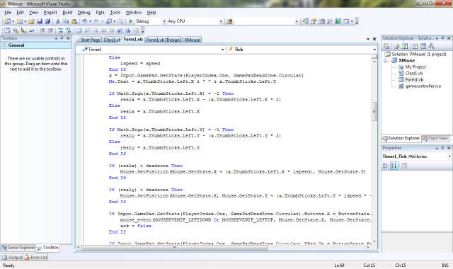

fhpuqrgrpgvirzhpujbj Posted May 7, 2009 Share Posted May 7, 2009 (edited) Control your computer with a 360 controller! [Requires Xbox Controller Plugged into computer (not with play-and-charge kit) and the drivers from MS installed] Anyway, it's not completely done, the mouse isn't as good as I would like and its not customizable but it's getting their. controls: A Click X Right Click Y Escape B Backspace Left Trigger Alt (Must Hold) Right Trigger Tab (Use with Left Trigger to use AltTab, tap to switch windows) Left Bumper Shift (Must Hold) Right Bumper Control (Must Hold) Left Stick MoveMouse Dpad Move Mouse in small increment if Left Stick isn't precise enough Right Stick (press) Close Window Right Stick (push up) maximze Right Stick (push down) minimize Right Stick (left/right) Restore Back BrowserForward Start StartMenu **The AltTab Buttons don't work when switching to IE8, and the min max and restore don't work with IE8. No idea why*** I plan to make dpad a custimzable shortcut launcher once mouse is more precise If I ever figure out how to use the guide button I'll switch start menu to it and make start a shortcut launcher Customizablitiy coming soon! XMouse.zip I know people like screenshots before they download stuff.. but it's a bit hard to 'show' this program but heres a screenshot of the code. Ignore the blank form, I need to hide that in the next release. *some people may need to install http://www.microsoft.com/downloads/details...;displaylang=en first* Edited May 7, 2009 by omnicoder Link to comment Share on other sites More sharing options...

Pupik Posted May 7, 2009 Share Posted May 7, 2009 Wanted to give it a try and see how it goes, but it crashes for me: Description: Stopped working Problem signature: Problem Event Name: CLR20r3 Problem Signature 01: xmouse.exe Problem Signature 02: 1.0.0.0 Problem Signature 03: 4a027303 Problem Signature 04: Microsoft.VisualBasic Problem Signature 05: 8.0.0.0 Problem Signature 06: 4889f422 Problem Signature 07: 6e Problem Signature 08: 8 Problem Signature 09: System.IO.FileNotFoundException OS Version: 6.0.6001.2.1.0.256.1 Locale ID: 1033 Read our privacy statement: http://go.microsoft.com/fwlink/?linkid=501...mp;clcid=0x0409 Anything to solve the problem? Link to comment Share on other sites More sharing options...
fhpuqrgrpgvirzhpujbj Posted May 7, 2009 Author Share Posted May 7, 2009 I was suspcious that might happen when VS didn't put the DLLs in the project folder. I believe it requires this from MS: http://www.microsoft.com/downloads/details...;displaylang=en Link to comment Share on other sites More sharing options...
Pupik Posted May 7, 2009 Share Posted May 7, 2009 Still getting the same crash error after installing that and restarting. And isn't this suppose to be in the PC gaming section, if not the software one? Link to comment Share on other sites More sharing options...
fhpuqrgrpgvirzhpujbj Posted May 7, 2009 Author Share Posted May 7, 2009 What OS are you using? Link to comment Share on other sites More sharing options...
Pupik Posted May 7, 2009 Share Posted May 7, 2009 Vista 32bit SP1, and 1.10.123.0 version of the XBOX 360 accessories software with the latest official drivers if that helps somehow. Link to comment Share on other sites More sharing options...
fhpuqrgrpgvirzhpujbj Posted May 7, 2009 Author Share Posted May 7, 2009 The thing I find strange is its a FileNotFound Error... the program doesn't use any IO... Hmm... I'll contact MS for support. It still works fine for me. Link to comment Share on other sites More sharing options...
