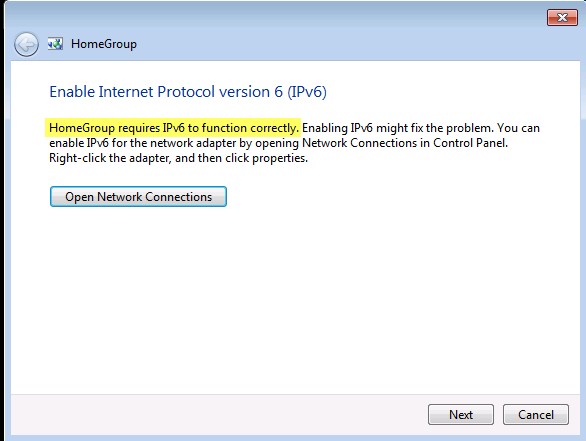

+BudMan MVC Posted June 19, 2009 MVC Share Posted June 19, 2009 I am not sure why, or even if really required -- but if you run the homegroup diagnostics. But like I said I do not have homegroups running, nor ipv6 - so when I went to enable it and run the diagnostics you get the above error. Now when I get a chance to play with it - this weekend, I will get the service running and create a homegroup, etc. and then see if I can turn off ipv6 and still have it work?? And once I have a homegroup enabled, etc. - will see if admin shares work, etc. But currently I have ipv6 completely disabled - since I have no use for it on my network. Link to comment Share on other sites More sharing options...
