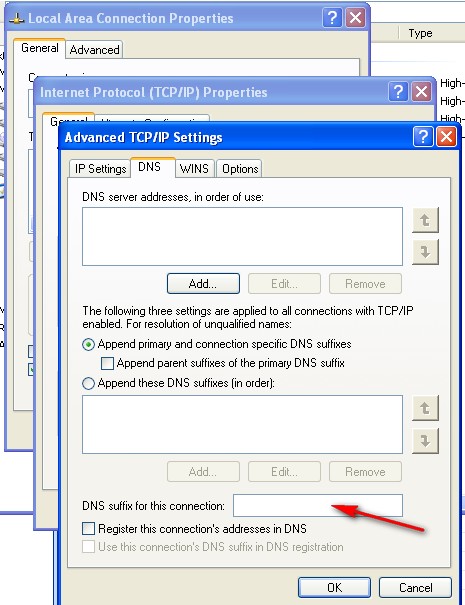

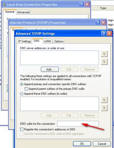

Well here is your issue
DNS Suffix Search List. . . . . . : gateway.2wire.net
You need to make that go away.
Connection-specific DNS Suffix . : gateway.2wire.net
Do you have something set here? For your connection
Your problem is your adding on gateway.2wire.net to everything you try and lookup.. You need to turn this off, you either have it hard coded or your dhcp server is handing it out.
Other than that - I doubt you have any reason to have IPv6 enabled -- I would disable it, since it serves no purpose at all if your not specifically using.. Uncheck the IPv6 protocol from your connection properties, or better yet disable it completely in the registry.
But your issue with this website is your search list.. You need to turn that off, since your router dns is returning an address for www.banamex.com.gateway.2-wire.net. So you never actually look for just www.banamex.com

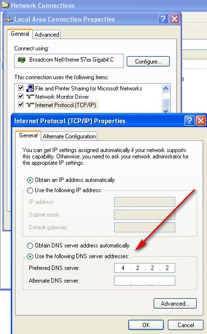

edit: Quick easy fix, do this
From a command prompt
D:\>nslookup
Default Server: dlisil01aut01
Address: 53.249.190.1
> server 4.2.2.2
Default Server: vnsc-bak.sys.gtei.net
Address: 4.2.2.2
> www.banamex.com
Address: 4.2.2.2
Non-authoritative answer:
Address: 192.193.206.100
If that resolves correctly set your dns to use 4.2.2.2
Edited by BudMan
Thank you very much BudMan... now it works... ;P

I just wanted to verify that you could do a lookup to another nameserver and get the correct response, before I told you to change your clients dns server. that server 4.2.2.2 command just told nslookup to ask 4.2.2.2 the questions, not machines default dns which is your router 192.168.1.254
You did set your machine to use 4.2.2.2 like the picture? If not you maybe just cached the correct entry and once that times out your going to have the same problem.. You need to set your computer to use a different dns server like 4.2.2.2
Or fix the problem of that suffix search list being set to .gateway.2-wire.net, you adding this to everything you search for.. Do another nslookup for say www.neowin.net

So the correct fix would be to figure out why your router is doing that?? It should NOT, you do not have any entries on your router do you? From the manual looks like you can had hosts to the routers dns server.
Changing your client to use 4.2.2.2 is what have been saying to do from the start of this thread, have your client use a different nameserver.. With your current suffix search list and your routers dns service, there seems to be a bug where it returns an address for www.banamex.com.gateway.2-wire.net what it should do is NXDOMAIN, and your machine would ask for www.banamex.com and it would then forward that to your isps dns, etc. and get the correct IP for it.
But the CORRECT fix would be to remove that suffix search list, you have NO need of it NONE!! And your adding that .gateway.2-wire.net to everything you look up!
You either need to setup your router not to hand that connection specific domain, gateway.2-wire.net out with dhcp, or you need to setup your machine with a static IP and not set that. Or just set your client to use a different dns server.. Which is what that 4.2.2.2 address is -- its a public dns server.
but currently with a suffix search list of gateway.2-wire.net every single query you do will ask for whateveritis+gateway.2-wire.net
And your issue is when you ask your router for www.banamex.com.gateway.2-wire.net its responding with an IP when it should not - its should respond with NXDOMAIN.

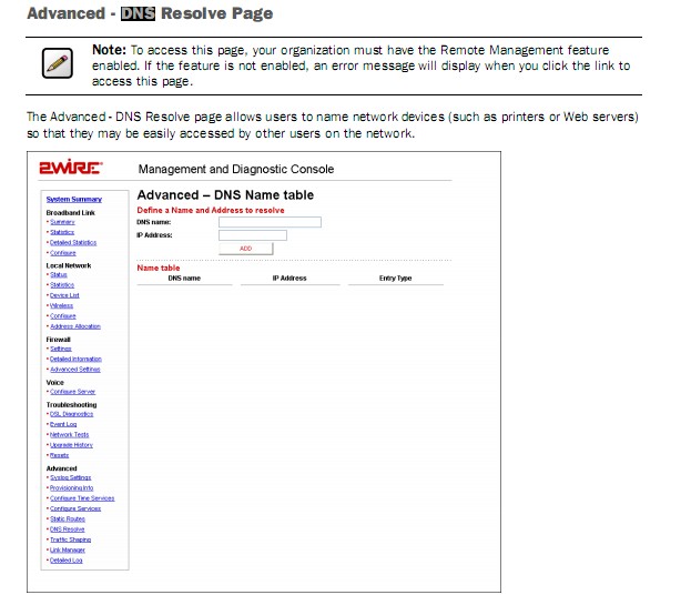

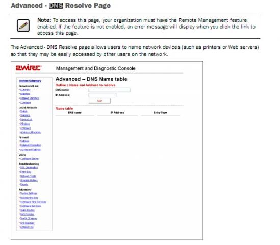

BudMan:
After the 4.2.2.2 affair, everything was working... then somehow I got into the MDC section of my router and THERE, under the DNS part was the problem (I know you posted a screen shot, but never could get in there on my own).
Now the question arise: How come I got the wrong IP in there???
Anyhow, I erased the entries and returned the system to normal (removed 4.2.2.2) and now I can get into Banamex without trouble.. (and bookmarked the router settings just in case)
Thank you very much for your patience..
Rick.
Now on to open another post on a (completely) different topic.
So you had a IP set for the banamex host, or you had the search order listed?
As to how a entry would get there for a host pointing to an IP? You would of had to put them there.
Where there lots of sites? Its not impossible that a malware/worm of some sort exploited your router and added entries for bank related sites, etc. for phishing purposes.
