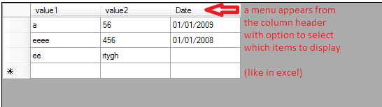

Hey All,
I've been searching high and low for a way to 'emulate' excel filtering in a grid view in the .NET app I am writing.. the reason being that on occasion very large datasets are being bound to my existing datagridview which is a complete pain to work with.. (however users need to have access to them all..)
The closest thing I have found (and what I'm currently working with) is this from MS: http://msdn.microsoft.com/en-us/library/aa480727.aspx
It does pretty much exactly what I'm after with the exception of multi-select (see attached)
Anyone have any suggestions?
Thanks!

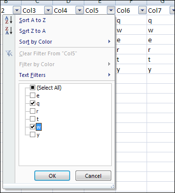

Ok, so.. I don't want to sort my columns I want to filter my rows by what is in the columns.
In excel you can filter on x items in that column which will act in the same way as a where clause would if you were doing Select * from Table
is there a control that anyone knows of that can emulate this.. to do the "where clause" in the UI, not on the query.. Preferably free, but I am not adverse to paying for it if necessary
