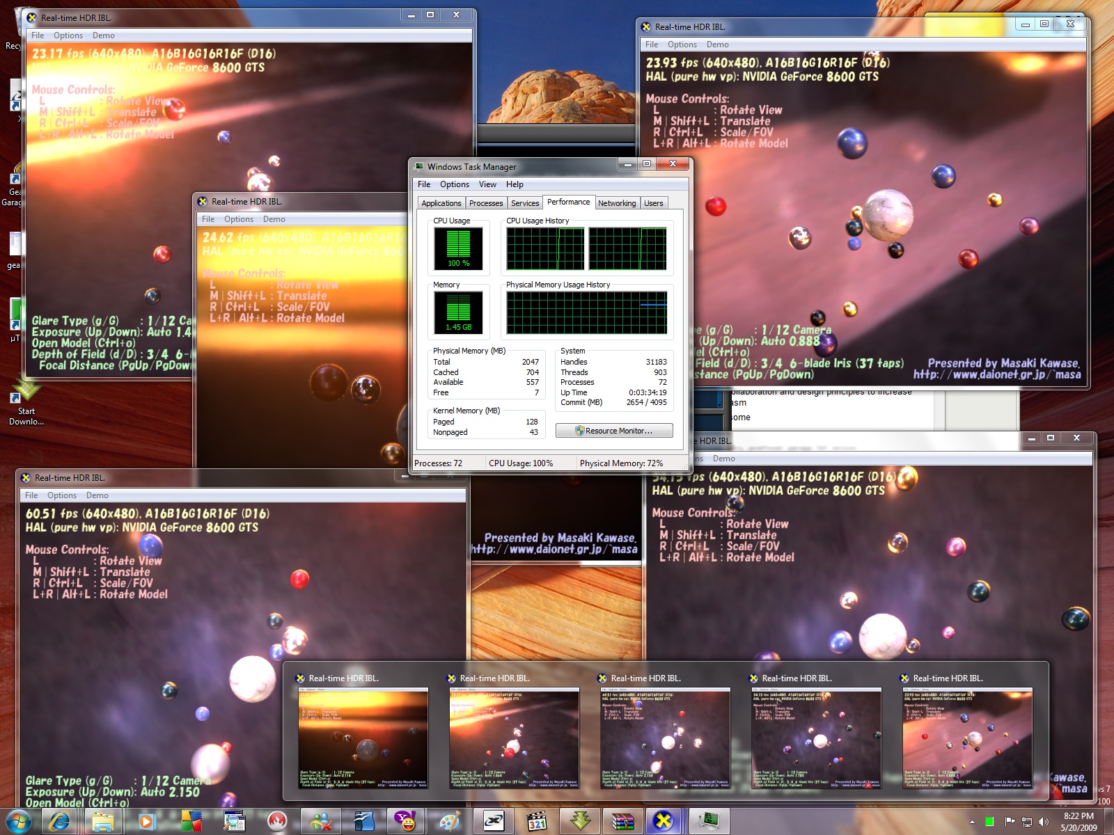

notuptome2004 Posted May 27, 2009 Share Posted May 27, 2009 How sure are you that there aren't different requirements? Its nonsensical of MS to but it on the requirements otherwise. well i am running windows 7 ultimate 64bit just fine on 2gb of ram with no slow downs the image below even tho i am 100% CPU usage the system is still darn responsive for about anything i do. Link to comment Share on other sites More sharing options...
