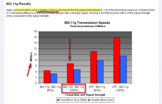

Ci7 Posted May 29, 2009 Share Posted May 29, 2009 Hmm. I'm not sure what the problem could be. I am using a DLink DGL-4500 gigabit router and two computers hardwired to it. One is using Windows 7 build 7127 and the other has Vista SP2. When I transfer files between them, I get about 60MB/s. When I transfer files to my wireless laptop, I get about 4MB/sec. Wireless transfers have always been slow for me. if you got Wireless-G which give 56Mb/s(equate about ~6MB/s max [which could bring it even slower if there are interferance/long distance latency etc] ) , that the most you would get from your laptop while your desktop , 1 Gb/s(which is about 125MB/s ) Link to comment Share on other sites More sharing options...
