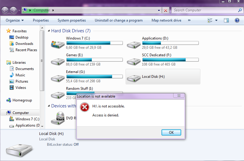

KiHu Posted June 5, 2009 Share Posted June 5, 2009 Oh Crap, Seems I've messed up big time now. In my spree to change user account settings for a limited account, I ended up locking one of my harddrives..for EVERYONE. Ive rebooted into safe mode, and ive checked all user accounts, and none of the accounts have access to the Security tab, nor do icacls or takeown have any chance or removing and changing the settings. Im sorry if im being troublesome, but I really need to get this harddrive working. and that Fast. ...also, hopefully without having to reformat. Ps: Running Windows 7 -dao. Link to comment Share on other sites More sharing options...
