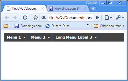

Take a look at the animation below. It shows what I have now and is a dHTML menu:
As you can see, it uses the full span of the browser.
The sub menus are all of fixed lengths (that's why Sub menu 2.3 wraps).
And the sub menus position themselves from the left end of the parent menu.
However, below is a mock up of what I want:
As you can see, the menu is now right aligned and doesn't use the fullness of the browser window.
The sub menus all have a MINIMUM width.
The sub menu also expands when the menu label is longer (e.g. Sub menu 2.3).
And the sub menu also positions itself from the right of it's parent.
How do I do this? I've included the code for the first example here:
dHTML_Menu.zipFetching info...
I'd really appreciate your help. Thank you.

Not sure how you would do it in a DHTML menu or it makes a difference being dhtml. But in html one would set it up as an unordered list and float ul tag to the right and li tag to the left. That way the element would take up the width they need. Padding can be used to provide the text some breathing space. Hope this helps.

  TonyLock said:
It is a CSS menu, what do you think the "d" stands for in "dHTML"?
DHTML = JavaScript + HTML (and maybe CSS)
That your menu does nothing at all if JS is disabled means it isn't using CSS for the actual display, it's using JavaScript.
Anyway, the problem is this bit of CSS you have in the ".jqueryslidemenu" selector
width: 100%;
Replace that with "float:right;"

I took a quick look at the code, I think this is what you mean:
<div style="width:100%">
<div style="right:0px;width:350px;position:absolute">
<div id="myslidemenu" class="jqueryslidemenu">
<ul id="nav">
	<li><a href="#">Menu 1</a>
		<ul>
			<li><a href="#">Sub Menu 1.1</a></li>
			<li><a href="#">Sub Menu 1.2</a></li>
		</ul>
	</li>
	<li><a href="#">Menu 2</a>
		<ul>
			<li><a href="#">Sub Menu 2.1</a></li>
			<li><a href="#">Sub Menu 2.2</a></li>
			<li><a href="#">This is a very long sub menu label 2.3</a></li>
		</ul>
	</li>
	<li><a href="#">Long Menu Label 3</a>
		<ul>
			<li><a href="#">Sub Menu 3.1</a></li>
			<li><a href="#">Sub Menu 3.2</a></li>
			<li><a href="#">Sub Menu 3.3</a></li>
		</ul>
	</li>
</ul>
<br style="clear: left" />
</div>
</div>
</div>
Put the #myslidemenu div inside a div telling it to stay right of the div with width of 100%.
Edit: you'll have to tune it yourself, thats just a rough edit.

Yeah, I used chrome when i was editing it, as for ie... i'll check it now...
Edit: Works perfect in IE8, is left aligned in IE7 and left aligned with padding on the third menu in IE6, maybe you could ad an alternate stylesheet for IE6 and IE7.
  • 0
Done. works perfectly with chrome, IE8 & safari, minor bug in IE7 with longer sub menu titles, extra padding below sub menu options in IE6. Overall animation works much better with right alignment than old menu.
Dropdown_Menu_2.zipFetching info...
