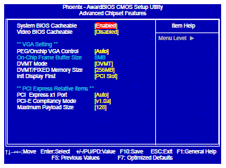

Shaun N. Posted June 12, 2009 Share Posted June 12, 2009 Hi guys, I have Windows 7 64 bit version installed but I can't find anywhere in my bios a place to enable memory remapping, Windows will still only use 3.25 Gigs of RAM. Either I can't find it/ or its not there. I'm wondering if it can still only use 3.25 of the available RAM are the programs still limited to the amount of memory they are able to use like in 32 bit OS? If they are then obviously i may aswell reinstall 32 bit Link to comment Share on other sites More sharing options...

Brodel Posted June 12, 2009 Share Posted June 12, 2009 I see a familiar word there, "Should" it isn't it shows "Useable 3.25 out of 4" What motherboard do you have? I know you said you can't find a place to enable memory remapping, what were you looking for in the bios? It should be listed as PAE (Physical Address Extension). Link to comment Share on other sites More sharing options...
Shaun N. Posted June 12, 2009 Author Share Posted June 12, 2009 http://www.foxconnchannel.com/Product/Moth...ID=en-us0000417 Foxconn G31MXP-K what were you looking for in the bios? Where I've googled I've found people being told to make sure Memory remapping is enabled but I've been through it a few times and can't for the life of me find it. Link to comment Share on other sites More sharing options...
jbo Posted June 12, 2009 Share Posted June 12, 2009 What are your settings on this page? Link to comment Share on other sites More sharing options...
Shaun N. Posted June 12, 2009 Author Share Posted June 12, 2009 I'll have to see later (at work atm) I'll let you know in a few hours. I think I tried disabling the PEG setting from auto and it didn't work...or it wouldnt boot. cant remember :p Link to comment Share on other sites More sharing options...

Shaun N. Posted June 12, 2009 Author Share Posted June 12, 2009 Ok, my settings are below I did however see this Display adapter type Radeon X1950 Series (Microsoft Corporation - WDDM) Total available graphics memory 1918 MB Dedicated graphics memory 512 MB Dedicated system memory 0 MB Shared system memory 1406 MB Link to comment Share on other sites More sharing options...
jbo Posted June 12, 2009 Share Posted June 12, 2009 It seems everything is in order. There is an update for your BIOS (dated 06/02/09), but there isn't a lot of documentation available. You could always try that if you haven't already... By the way, I have the same video card running on build 7100 x64, mine shows as: Total available graphics memory 2014 MB Dedicated graphics memory 256 MB Dedicated system memory 0 MB Shared system memory 1758 MB Link to comment Share on other sites More sharing options...

strelok1911 Posted June 13, 2009 Share Posted June 13, 2009 no it's because of the chipset (southbridge i think?) everything is 64bit but the southbridge isn't. I have THE same problem with my gigabyte ga-945g-s3. It doesn't uses the full 4 gb ram. Link to comment Share on other sites More sharing options...
Lamp Post Posted June 18, 2009 Share Posted June 18, 2009 no it's because of the chipset(southbridge i think?) everything is 64bit but the southbridge isn't. I have THE same problem with my gigabyte ga-945g-s3. It doesn't uses the full 4 gb ram. The southbridge is in no way related to the memory mapping. That is done at the northbridge. The similarity between your and the OP's mobo is that they both run northbridge chipsets (945G and G31) with a memory capacity of 4GB. This means that these 4GB also has to be used for mapping hardware memory. Hence the 3.25GB available for applications. In theory the motherboard does support 64-bit memory mapping, it just doesn't support high enough memory values to take use of it. Link to comment Share on other sites More sharing options...
