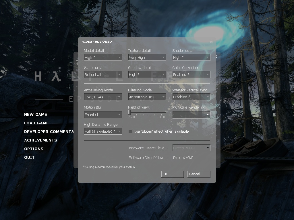

Hell-In-A-Handbasket Posted June 28, 2009 Share Posted June 28, 2009 havent played the game in a while, and previous system i was runnign it on is nowhere near the spec's of my current rig it seems im unable to select Multi-core rendering, the drop down is empty, any ideas or or it default on Current Specs are Windows 7RC Intel i7 920 Asus PT6T6 WS REvolution 6GB DDR3 BFG GTX280 x2 in SLI Link to comment Share on other sites More sharing options...

Yusuf M. Veteran Posted June 28, 2009 Veteran Share Posted June 28, 2009 I just checked with my installation of Half-Life 2: Episode Two and I too don't have the option to enable multi-core rendering. They have it enabled by default for systems with two, three, or four cores. I know that because I cross-checked some console commands with Left 4 Dead. Here are the (default) commands I checked: r_threaded_particles 1 mat_queue_mode -1 You can use these commands to force multi-core rendering: r_threaded_particles 1 r_threaded_renderables 1 mat_queue_mode 2 My advice is to just leave it at the default settings. Link to comment Share on other sites More sharing options...

The_Decryptor Veteran Posted June 29, 2009 Veteran Share Posted June 29, 2009 I just checked with my installation of Half-Life 2: Episode Two and I too don't have the option to enable multi-core rendering. They have it enabled by default for systems with two, three, or four cores. I know that because I cross-checked some console commands with Left 4 Dead. Here are the (default) commands I checked: r_threaded_particles 1 mat_queue_mode -1 You can use these commands to force multi-core rendering: r_threaded_particles 1 r_threaded_renderables 1 mat_queue_mode 2 My advice is to just leave it at the default settings. It's enabled by default in L4D, but L4D isn't on the same engine revision as EP2, EP2's multi-core stuff is buggier (to the point where it might slow down the game) Link to comment Share on other sites More sharing options...

Yusuf M. Veteran Posted June 29, 2009 Veteran Share Posted June 29, 2009 It's enabled by default in L4D, but L4D isn't on the same engine revision as EP2, EP2's multi-core stuff is buggier (to the point where it might slow down the game) Ah, I kinda had a feeling that would be the case. I thought Valve updated the Source engine in The Orange Box games to Protocol 37, Build 3679. After all, they did add the multi-core rendering option to Team Fortress 2 and Half-Life 2: Episode Two. I know it used to be a hidden console command but the fact that they made it an option in the advanced video menu made me think that it was "working" properly. Link to comment Share on other sites More sharing options...
Athernar Posted June 29, 2009 Share Posted June 29, 2009 Not totally sure, but I don't think EP2 has "support" like TF2 does. TF2 is protocol 15 whereas EP2 is protocol 14. Not that TF2's multicore is particularly helpul in the first place. (It gives me a -9 FPS drop enabled.) Link to comment Share on other sites More sharing options...
Hell-In-A-Handbasket Posted June 29, 2009 Author Share Posted June 29, 2009 suprising since TF2 wigs out after a couple minutes, yet NPF with HL2EP2. im assuming the protocol is same as engine version Not totally sure, but I don't think EP2 has "support" like TF2 does. TF2 is protocol 15 whereas EP2 is protocol 14.Not that TF2's multicore is particularly helpul in the first place. (It gives me a -9 FPS drop enabled.) Link to comment Share on other sites More sharing options...
Athernar Posted June 29, 2009 Share Posted June 29, 2009 suprising since TF2 wigs out after a couple minutes, yet NPF with HL2EP2.im assuming the protocol is same as engine version Eh, sort of. But it's not really consistant enough to be relied on. Case in point; The original HL2 version of Source was Protocol 7, and even after EP1/DoD:s added Phong/HDR it was still 7, until the TF2 beta which was 8. (Updates during the TF2 beta slowly pushed the version to 14) Link to comment Share on other sites More sharing options...
